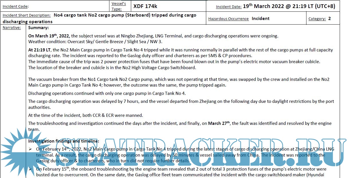

Year: 2022
Author: Gaslog
Genre: Documentation
Pages count: 13

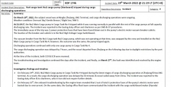

Description: On March 19th, 2022, the subject vessel was at Ningbo Zhejiang, LNG Terminal, and cargo discharging operations were ongoing.
Weather condition: Overcast Sky/ Gentle Breeze / Slight Sea / NW 3.
At 21:19 LT, the No2 Main Cargo pump in Cargo Tank No 4 tripped while it was running normally in parallel with the rest of the cargo pumps at full capacity discharging rate. The incident was reported to the Gaslog duty officer and charterers as per SMS & CP procedures.

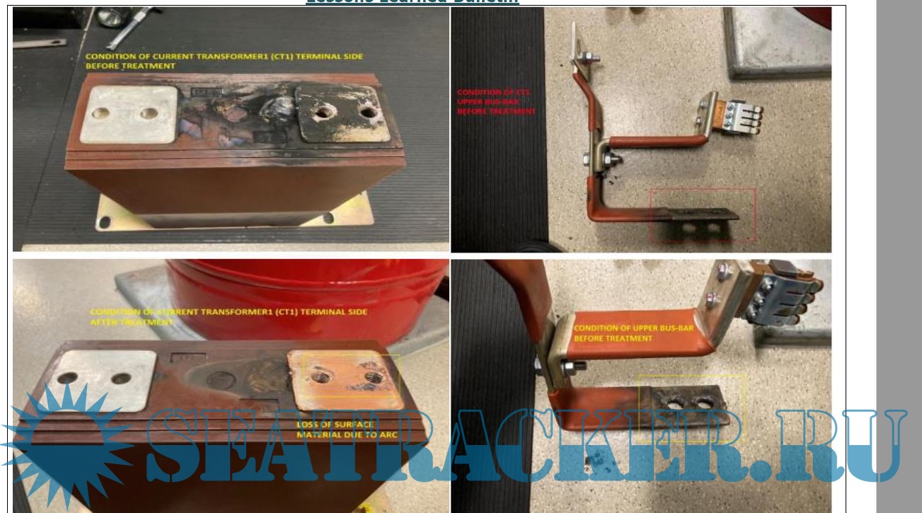

The immediate cause of the trip was 2 power protection fuses that have been found blown out in the pump’s electric motor vacuum breaker cubicle.
The location of the breaker and cubicle is in the No2 High Voltage Cargo Switchboard.
