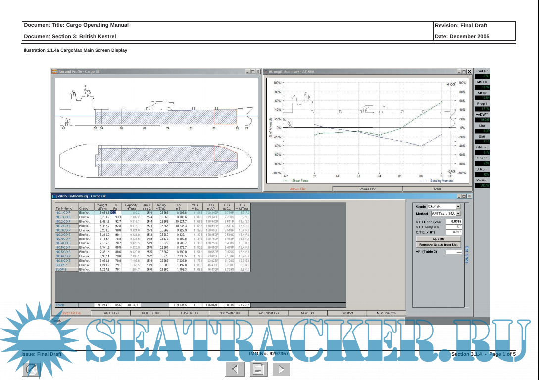

3.1.4 Loading Computer

3.1.4a CargoMax Main Screen Display
3.1.4b CargoMax Ballast Screen Display

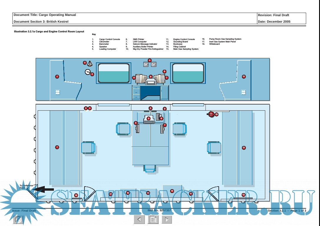

3.2 Centralised Control Room, Console and Panels
3.2.1 Cargo Control Centre
Illustrations
3.2.1a Cargo and Engine Control Room Layout
3.2.1b Cargo Control Room Console Layout
