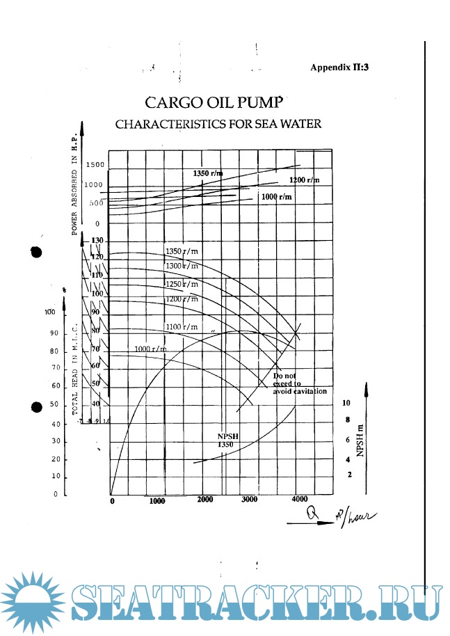

The simple goal of this manual, is to give you the necessary knowledge how to get maximum capacity out
of your ships cargo pumps and stripping equipment. And, of course, the knowledge to run your pumps
safely.

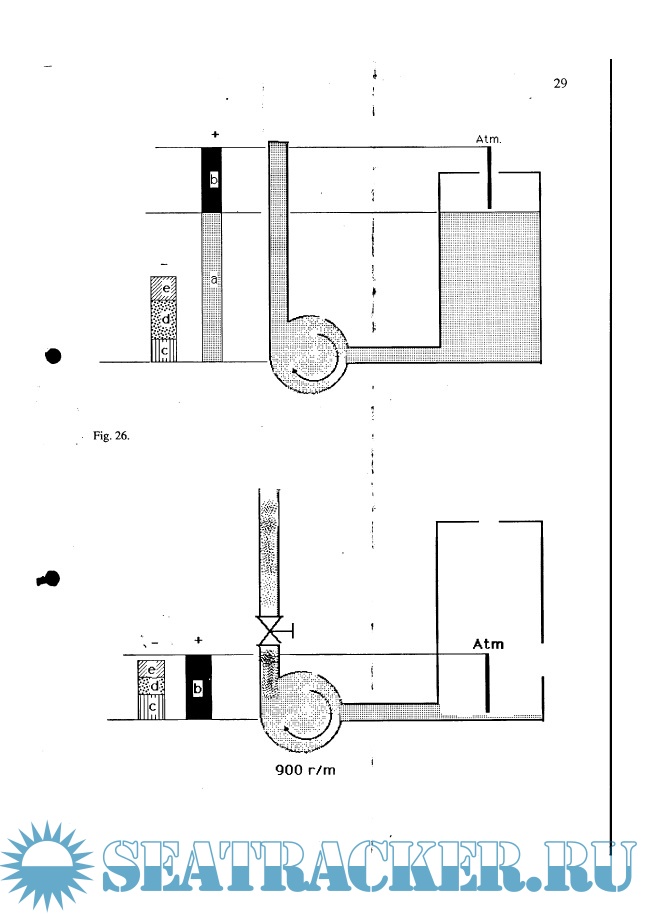

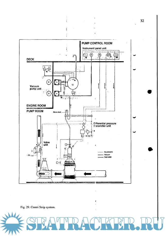

The idea is that, step by step, you shall follow and study what happens on board while discharging a
cargo of crude oil.
We are going to show you what happens on board our ship, the M/T LAGUNA, while you are comparing
actions, procedures, and equipment used in your own ship.
No ship is the same, but the principles, how to use any ship's pumps are the same.
