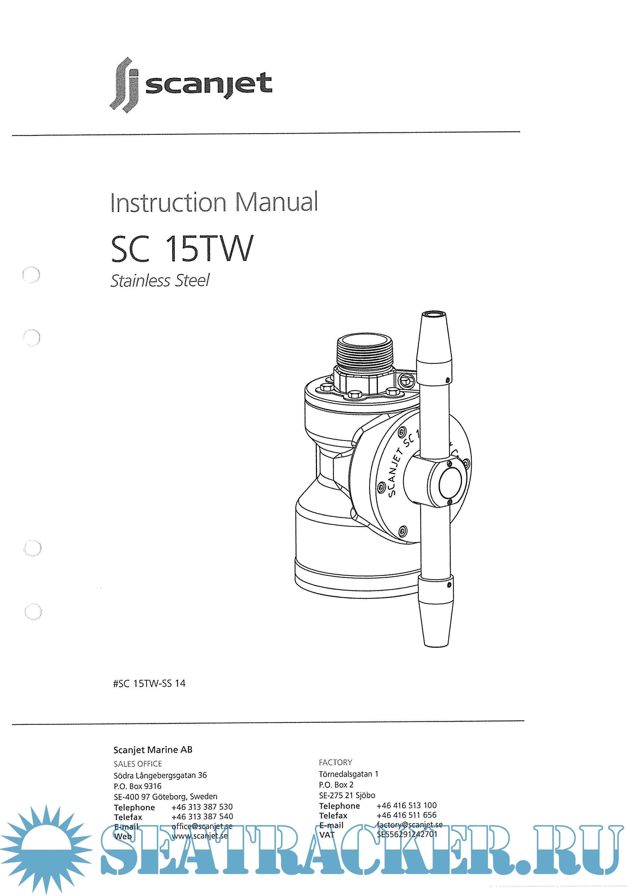

ScanJet SC 15TW Instruction Manual
Year: 2012
Author: www.scanjet.se
Pages count: 43
Description: SCANJET SC 15TW is a tank cleaning machine specially developed for cleaning
of cargo and slop-tanks on board chemical carriers/product carriers and other
applicable tanks. The size, construction and cleaning requirements of these tanks
are design criteria, which have been evaluated prior to installation. The SC 15TW
could be used as fixed installed machine as well as for portable use.

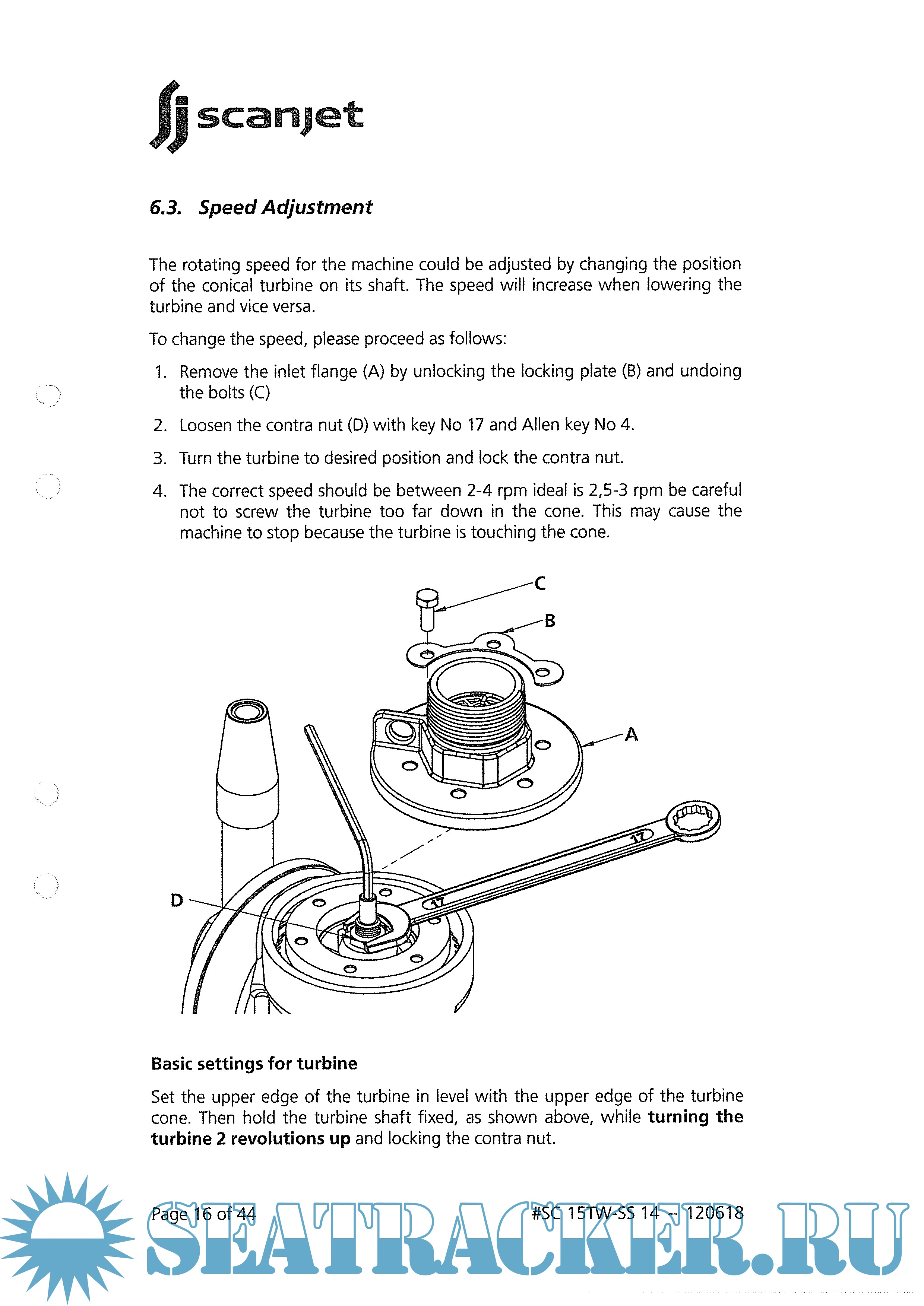

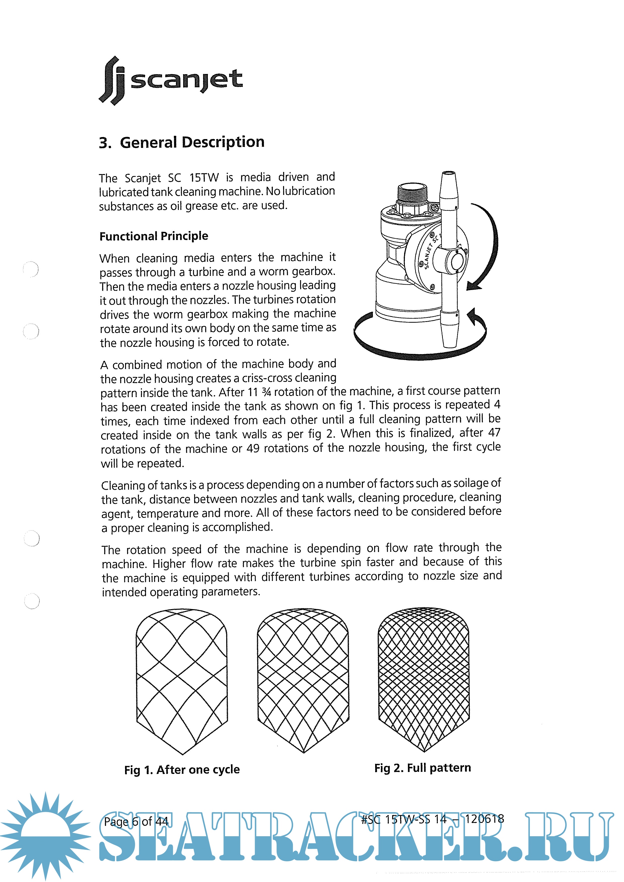

The cleaning procedure will start by open the valve for cleaning media. The
water flow will pass over a turbine inside the machine and the nozzles will
rotate creating a crisscross cleaning patten inside the tank. When the cleaning
procedure is finalized the valves are to be closed.
SC 15TW is as standard delivered with two or four nozzles, and nozzle sizes
between d6 mm and d10 mm.

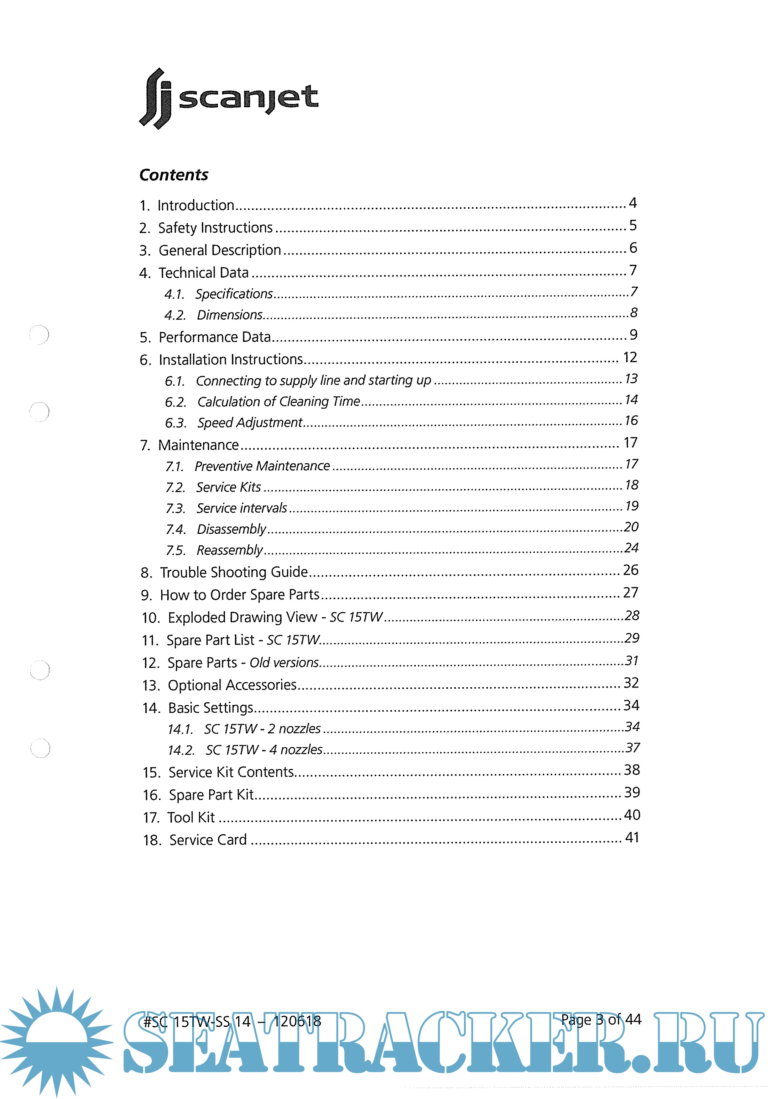

This manual has been prepared as a guide to facilitate for persons who will be
operating and maintaining the tank cleaning machine. The key for long tank
cleaning machine life will always be carefully planned maintenance, the tank
cleaning machine is actually doing a rough and dirty job for you. With proper
maintenance the Scanjet SC 15TW will keep servicing you for many years.
