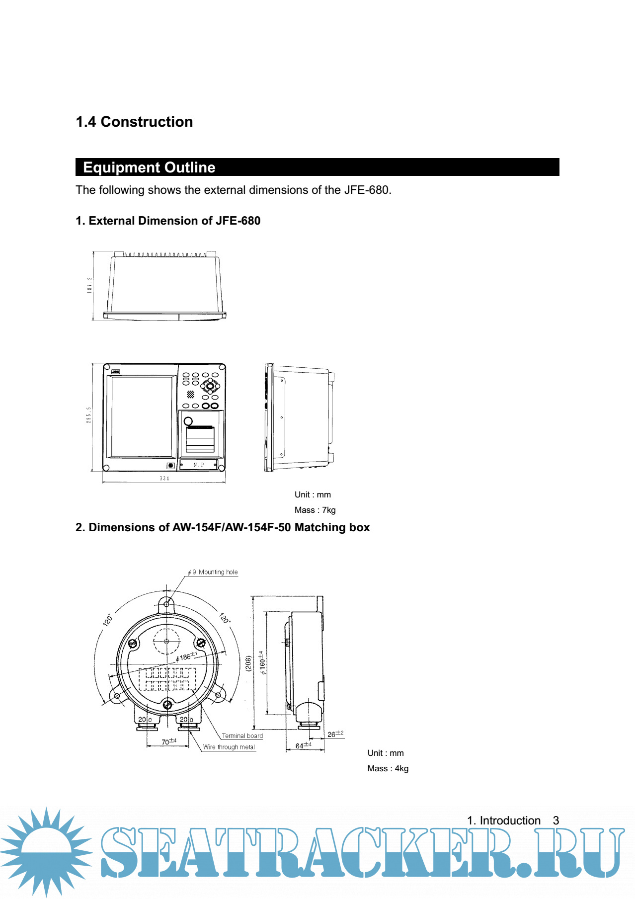

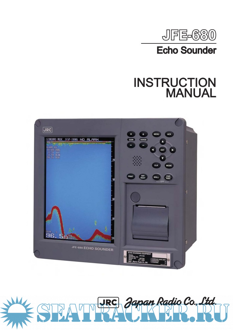

Description: The JFE-680 Echo-Sounder consists of a transducer mounted on the bottom of the ship's
hull and a main unit that displays information on the depth and formation of the seabed.
This information is gained by using ultrasonic waves sent from the transducer that are then
reflected off the sea bottom and picked up again by the transducer. The JFE-680 also has
the following functions:
(1) depth alarm, (2) power fail alarm, (3) output of depth data, (4) output of depth and power
fail alarms.
Features
The JFE-680 features the following:
• Three display modes; standard, history, and docking.
• Depth data for last 24 hours in memory to play back the past sounding information.
• Dual frequency mode and two transducers are available in option. (*requires an optional
equipment)
