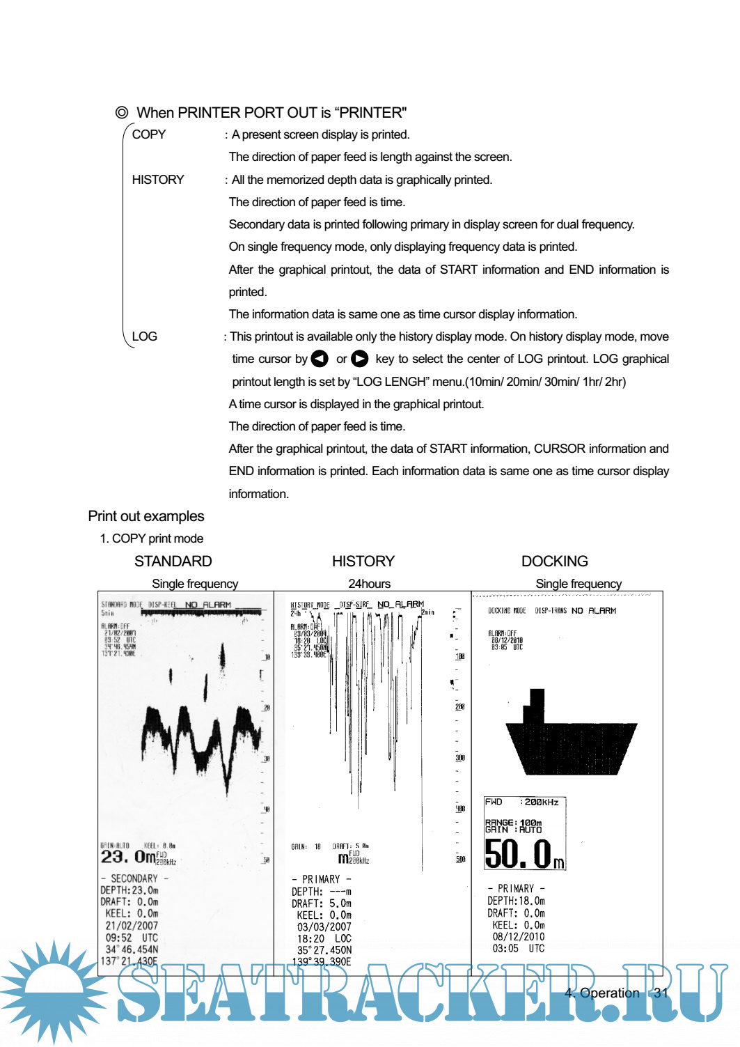

Features:
The JFE-380 features the following:
• Three display modes; standard, history, and docking.
• Depth data for last 24 hours in memory to play back the past sounding information.
