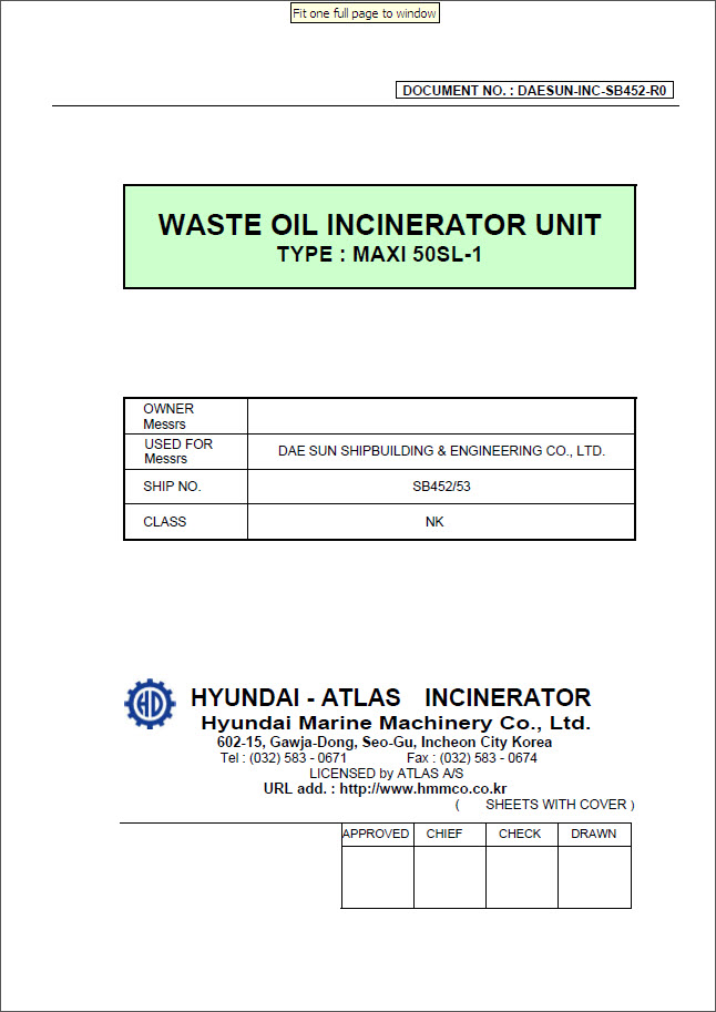

WASTE OIL INCINERATOR UNIT TYPE : MAXI 50SL-1
Year: 2005
Author: Hyundai
Genre: INSTRUCTION FOR OPERATION
Publisher: Hyundai Marine Machinery Co., Ltd.
DOCUMENT NO: DAESUN-INC-SB452-R0
Quality: OCR without errors
Number of pages: 167
Description: INSTRUCTION BOOK FOR W. O. INCINERATOR TYPE : MAXI 50SL-1 HMMCO Hyundai Marine Machinery Co., Ltd. Page 8
DESCRIPTION OF HYUNDAI-ATLAS INCINERATOR TYPE MAXI 50 SL-1
