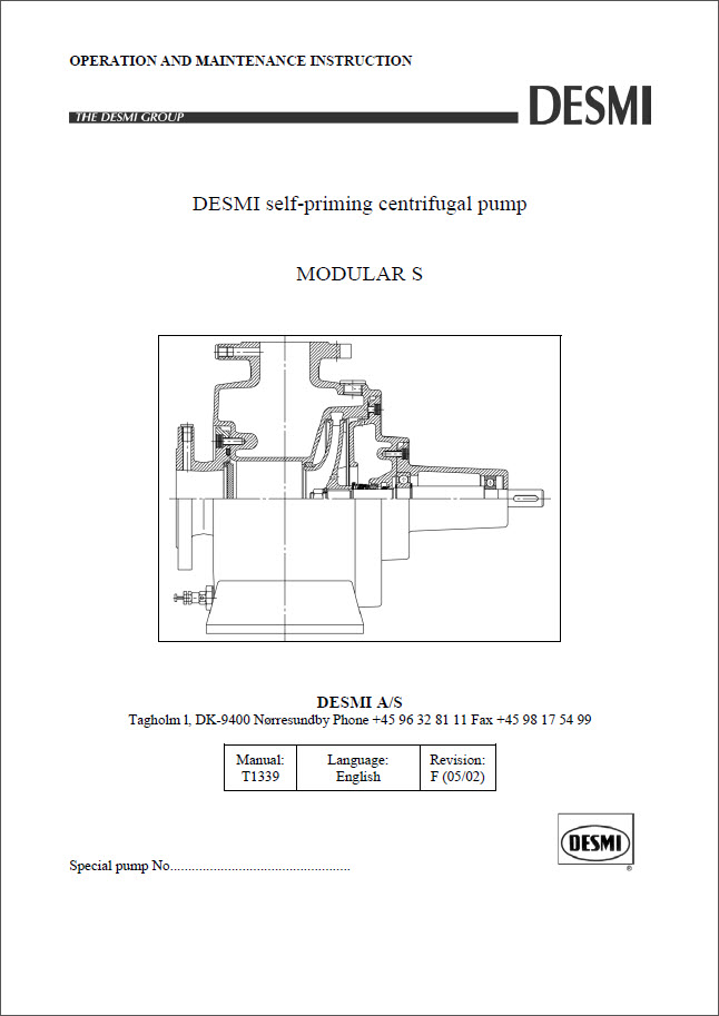

DESMI self-priming centrifugal pump MODULAR S / OPERATION AND MAINTENANCE INSTRUCTION
Year: 2003
Author: DESMI
Genre: INSTRUCTION
Publisher: DESMI A/S
Quality: OCR without errors
Number of pages: 20
Description: These operation and maintenance instructions apply to the DESMI MODULAR S pump series. The pumps
are available in sizes ranging from 25 to 100 mm on the pressure flange. The suction flange is bigger than the
pressure flange.
DESMI S is a single-stage self-priming centrifugal pump with stainless steel shaft and mechanical shaft seal.
The smallest pumps, S-32-25-110 and S-50-32-135, have open impeller, whereas all other sizes have closed
impeller.
The pump is suitable for the pumping of clean and polluted liquids with temperatures between 0 and 80°C.
With special shaft seal up to 140°C. Max. number of revolutions: 3600 RPM.
The pump has horizontal inlet on the centre line and vertical outlet at the top.
The back of the impeller is equipped with relief blades to reduce the load on the bearings.
Relief holes in the impeller ensure circulation of liquid for the shaft seal and prevent overheating of the shaft
seal during normal operation.
The pump is particularly suitable for the pumping of water in connection with e.g. cooling of diesel engines,
as bilge pumps, ballast pumps, pumps for irrigation, washing plants, air conditioning, cooling systems, and
sanitary systems, etc. Furthermore, in the majority of cases where the transport of liquid is required within
industry.
