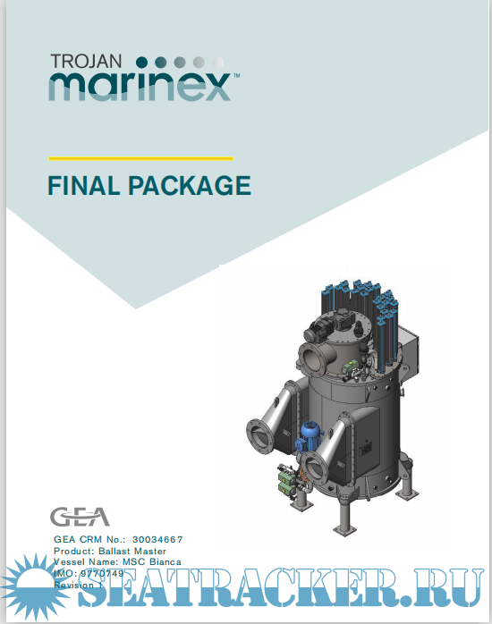

Ballast Water Treatment System (Trojan marinex)
Year: 2017
Author: Trojan marinex
Genre: Instruction
Number of pages: 399

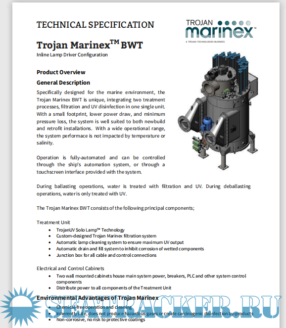

Description: General Description

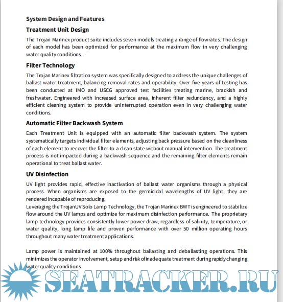

Specifically designed for the marine environment, the Trojan Marinex BWT is unique, integrating two treatment processes, filtration and UV disinfection in one single unit.
With a small footprint, lower power draw, and minimum pressure loss, the system is well suited to both newbuild and retrofit installations. With a wide operational range, the system performance is not impacted by temperature or salinity.
Operation is fully-automated and can be controlled through the ship’s automation system, or through a touchscreen interface provided with the system.
During ballasting operations, water is treated with filtration and UV. During deballasting operations, water is only treated with UV.The Trojan Marinex BWT consists of the following principal components;
Treatment Unit
• TrojanUV Solo Lamp™ Technology
• Custom-designed Trojan Marinex filtration system
• Automatic lamp cleaning system to ensure maximum UV output
• Automatic drain and fill system to inhibit corrosion of wetted components
• Junction box for all cable and control connections
