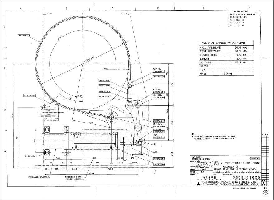

REFERENCE DRAWINGS
REFERENCE DRAWINGS '1 Mechanical equipment
(1) Arrangement of in post (No. 1 crane) DSC7107612
(2) Arrangement of in post (No. 2~4crane) DSC7107622
(3) Arrangement of cab. DSC1104932
(4) Arrangement of hoisting & luffing winch DSC2103110
(5) Luffing device (sectional dwg & parts list) DSC2102630
(6) Slewing device
(a) MRP1703D-375-99A Outline dwg. (G3999342) DSC2102500
(b) MRP1703D-375-99A Sectional dwg. (G3009902, G4004723)
(7) Assembly of brake gear for hoisting winch DSC2102653

The hoisting winch braking system has two (2) systems, one is hydraulic blocking system (counter balance valve) and the other is hydraulic band braking system.
The band brake is fitted to drum flange, and can be applied by the spring force and released by hydraulic pressure.
The material of the brake lining is of asbestos-free.
Hoisting winch is provided with a pinch roller.
The luffing winch braking system has two (2) systems, one is hydraulic blocking system (counter balance valve) and the other is hydraulic disc braking system.

The electric motor for the hydraulic pump is to be started by the method (three contactor method) and the starting current is to be decreased in one-third of directly starting.
(a) Three phase induction motor for marine use
(b) Totally enclosed with outside fan squirrel cage rotor equipped with
ball bearings
(c) Insulation class F
(d) With space heater & thermal switch
(e) I EC numbers of protection IP55
(4) Motor for oil cooler
The electric motor for oil cooling fan can be automatically operated by the oil temperature while the electric motor for the hydraulic pump is operated. The electro-magnetic switch is actuated by the thermostat for detecting oil temperature which is inserted in the hydraulic piping and causes the motor to operate.
shield balI bearings
(d) Direct start
(e) IEC numbers of protection IP55
(5) Starter panel
Use for starting circuit of main motor for hydraulic oil pump & motor for oil cooler and other.
Including control transformer & diode stack for control circuit, etc. Constructed by steel plate and drip-proof type (IP22).
Installed in machine room of deck crane.
(6) Control stand for single crane
Control circuit including control switch, indicating lamp and control relays is built in this control stand.
Installed in cabin of deck crane.
(7) Electric cable
All cables installed throughout the deck crane shall be of Japanese Industrial Standard (JIS) and of 0. 6/1kV or 250V grade insulation to meet the voltage to which they are subjected.
The conductors supplying single load, in general, shall have continuous current carrying capacity equal to 100% of the rating of the connected load.
(8) Slipring
Installed in the fixed post of ship’s deck.
