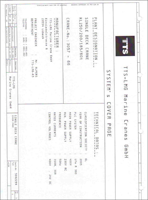

LMG Marine Crane KL250/200/185/60t GmbH
Year: 1997
Author: TTS
Genre: INSTRUCTI0N MANUAL
Publisher: TTS
Number of pages: 151
Description: TTS-LMG Marine Cranes GmbH 7/3063-7/3064 ELECTRICAL EQUIPMENT DISPLAY AND INDICATORS
