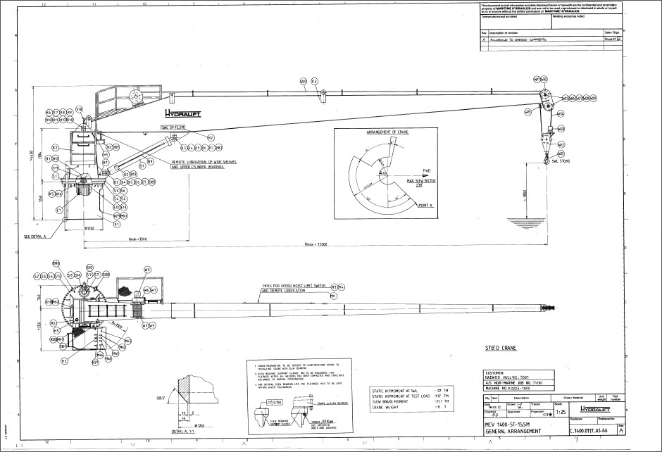

Description: This Hydralift crane is to be welded directly to the deck or some othertypeofsupport.
As a minimum requirement (of the various classification
organizations) the deck must be designed to withstand the cranes max. bending moment with a 25% overload.
MOTE: 1. To avoid distortion of slew bearing support flange, we
recommend to weld the crane base to substructure before crane slew bearing is connected to crane base.
2. Check adjoining welding grooves to obtain an even gap through the circumference. Also an evenly distributed heat input is required to avoid distortion.
3. The flange is obviously more exposed to distortion if
deck stiffeners , platforms etc. are welded to crane base. All such welding has to be completed and the
structure has to return to normal temperature before the slew bearing support flange is measured for flatness.
4. For optimal slew bearing life the base flange flatness
has to be kept within given tolerances, see G.A.
drawing.
Before mounting base and slew bearing together check the
following: ‘
1. Flange machined surface is clean and free from paint and welding slag, etc.
2. Check bolt lenght. Only bolt type indicated in the parts list are to be used.
3. The bolt holes in the base flange must natch so that the bolts go freely through the holes and without resistance when rotated in the holes.
4. Hardened washers as indicated in parts list and on G.A.
drawing are to be used under bolt heads.
5. The tightening torque indicated on the G.A. drawing is based
upon lightly oiled bolt thread surface. Ue recommend lubricating with MOLYCOTE 1000 because of its relative
stability between tightening torque and bolt tension with
special consideration given to re-tightening. MOLYCOTE 1000
is also a corrosion inhibitor.

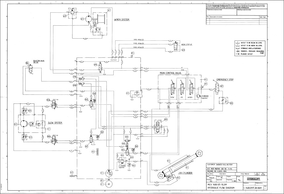

For hydraulic components:
2 pc Oil filter cartridge
1 pc Shaft seal for hydr. pump
1 pc Shaft seal for hydr. winch motor
1 pc Shaft seal for hydr. slew motor

LIST OF OIL QUANTITIES See also lubrication chart for right grade and type o
System oil : 500 liters
Winch gearbox : 2,8 liters
Slew gearbox : 8,0 liters

1. CRANE FOUNDATION TO BE WELDEO TO SUBSTRUCTURE PRIOR TO INSTALLING CRANE WITH SLEW BEARING.
2. SLEW BEARING SUPPORT FLANGE HAS TO BE MEASURED FOR FLATNESS AFTER ALL WELDING HAS BEEN COMPLETED AND STRUCTURE RETURNEO TO NORMAL TEMPERATURE.
3. FOR OPTIMAL SLEW BEARING LIFE THE FLATNESS HAS TO BE KEPT WITHIN GIVEN TOLERANCES.
0,190
SLEW BEARING SUPFDRT FLANGE
"-3L. CRANE w/SLEW BEARING
TORQUE = 62Kpm USE SPECIFIED BOLTS AND WASHERS
CUSTOMER:
DAEWOO HULL NO.: 5501
STATIC KIPMOMENT AT SWL. : 97 TM
STATIC KIPMOMENT AT TEST LOAD :117 TM
SLEW BRAKE MOMENT •• 21.1 TM
CRANE WEIGHT >8 T
A/S NOR-MARINE JOB NO.:71/90 MACHINE NO. K2S25-1890

H MAIN SYSTEM
HI 14431 MAIN PUMP 1 PA 1911 R3B26A
H2 MAIN CONTROL VALVE 1 VB 1107 NDN P-175, LH ASSY
H3 11250 HYDR. OIL FILTER 1 TTF-170
H4 11259 FILTER ELEMENT FOR H3 1 TXX4-10
H5 15058 HYDR. OIL FILLING ARR. 1 EF4-50HY 2" BSP
H6 15049 . HYDR. OIL LEVEL INDICATOR 1 UC-FL-213
H7 | DRAIN VALVE 1 51-1" w/PLUG
H8 11993 MINIMESS PRESSURE POINT 1 ST-04, R 1/4" BSP 316
Hll RUBBER SEAL FOR PUMP 1 2mm NEOPRENE
H12 STUD BOLTS FOR PUMP w/NUT 4 M12x30, DIN 938-8.8
H13 15061 INITIAL SERVO PRESS .VALVE 1 VDR R16-C2
H27 14403 EMERGENCY STOP VALVE 1 SSV 09x9L Hy
(P-K)PK-1400-66
DESCRIPTION QTY. SPECIFICATION

Tolerances except as noted Welding except as noted
Rev. Description of revision Date / Sign.
1 CRANE FOUNDATION TO 8E WELDED TO SUBSTRUCTURE PRIOR TO INSTALLING CRANE WITH SLEW BEARING
FLATNESS AFTER ALL WELDING HAS BEEN COMPLETED AND STRUCTURE RETURNED TO NORMAL TEMPERATURE.
3 FOR OPTIMAL SLEW BEARING LIFE THE FLATNESS HAS TO BE KEPT WITHIN GIVEN TOLERANCES.
TORQUE = 62Kpffi USE SPECIFIED BOLTS AND WASHERS
STATIC KIPMOMENT AT SWL : 97 TM
STATIC KIPMOMENT AT TEST LOAD ■117 TM
SLEW BRAKE MOMENT •21,1 TM
CRANE WEIGHT :~8 T
10
PORT CRANE
CUSTOMER
DAEWOO HULL NO.:5501
A/S NOR-MARINE JOB NO 71 /90 MACHINE NO K2826-1890
A/S HYDRALIFT
PAGE 1 OF 6
PARTS LIST
Revised;08.05.90 TL/rbj
DRW. REF. :C. 1400.0117.Al-67
C. 1400.0117.A1-67H
CRANE TYPE : MCV 1400-5T-15,5M MACHINE NO.: K2826-1890

H MAIN SYSHM
H6 15049 HYDR. OIL LEVEL INDICATOR 1 UC-FL-213
H7 DRAIN VALVE 1 51-1" w/PLUG
H12 STUD BOLTS FOR PUMP w/NUT 4 Ml2x30, DIN 938-8.8
H27 14403 EMERGENCY’ STOP VALVE 1 SSV 09x9L Hy
(P-K)PK-1400-67

51 13905 SLEW RING 1
52 BOLTS FOR SLEW RING, 54
OUTER RING. TYPE 1.
53 BOLTS FOR SLEW RING, 6
OUTER RING. TYPE 2.
54 BOLTS FOR SLEW RING, 60

K MECHANICAL COMPONENTS
Kl (B) CRANE BASE 1 DRW.NO. :C. 1400.0150.Al. 1011
K2 (B) CRANE KING 1 DRW.NO. :C. 1400.0150.Al.2015
K3 (B) CRANE JIB 1 DRW.NO. :C. 1400.0117.Al.3026
K5 14391 FLEXIBLE COUPLING 1 RADAFLEX 300-16
K6 13943 JIB BEARING 2 GE 120 DO
K7 14501 SEAL RING FOR JIB BEARING 2 V 220A
K8 (B) JIB BOLT 1 DRW. :C. 1400.0150.A2.7007
K9 (B) LOCK PLATE FOR JIB BOLT 1 DRW. :C.1400.0150.A2.7008
K10 LOCK BOLT FOR LOCK PLATE 1 M30x80, DIN 933-8.8
Kll (B) BOLT FOR JIB BOLT
w/LUB. NIPPLE 1 M30x50, DIN 933-4.6
K16 (B) SET SCREW FOR
COUPLING PARTS 2 M8xl5, STAINLESS
K17 (B) LUB. NIPPLE 2 PT 1/8" (JIS P1575)
K18 PLUG 1 504-6
K19 PACKING FOR INSP. HATCH
KING (NO. 1) 1 2mm NEOPRENE, 2x0620
K20 PACKING FOR INSP. HATCH
KING (NO.2) 1 2mm NEOPRENE, 2x115x200
K23 PACKING FOR INSPECTION
HATCH BASE 1 2mm NEOPRENE 2x700x830
(P-K)PK-1400-67

i I i OUTLET TO BE BELOW OIL LEVEL i I i OUTLET TO BE ABOVE OIL LEVEL HYDRAULIC HOSE w/COUPLINGS -<>H MINIMESS- PRESSURE MEASURING —X PLUGGED OUTLET P0WT
