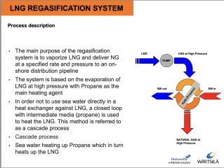

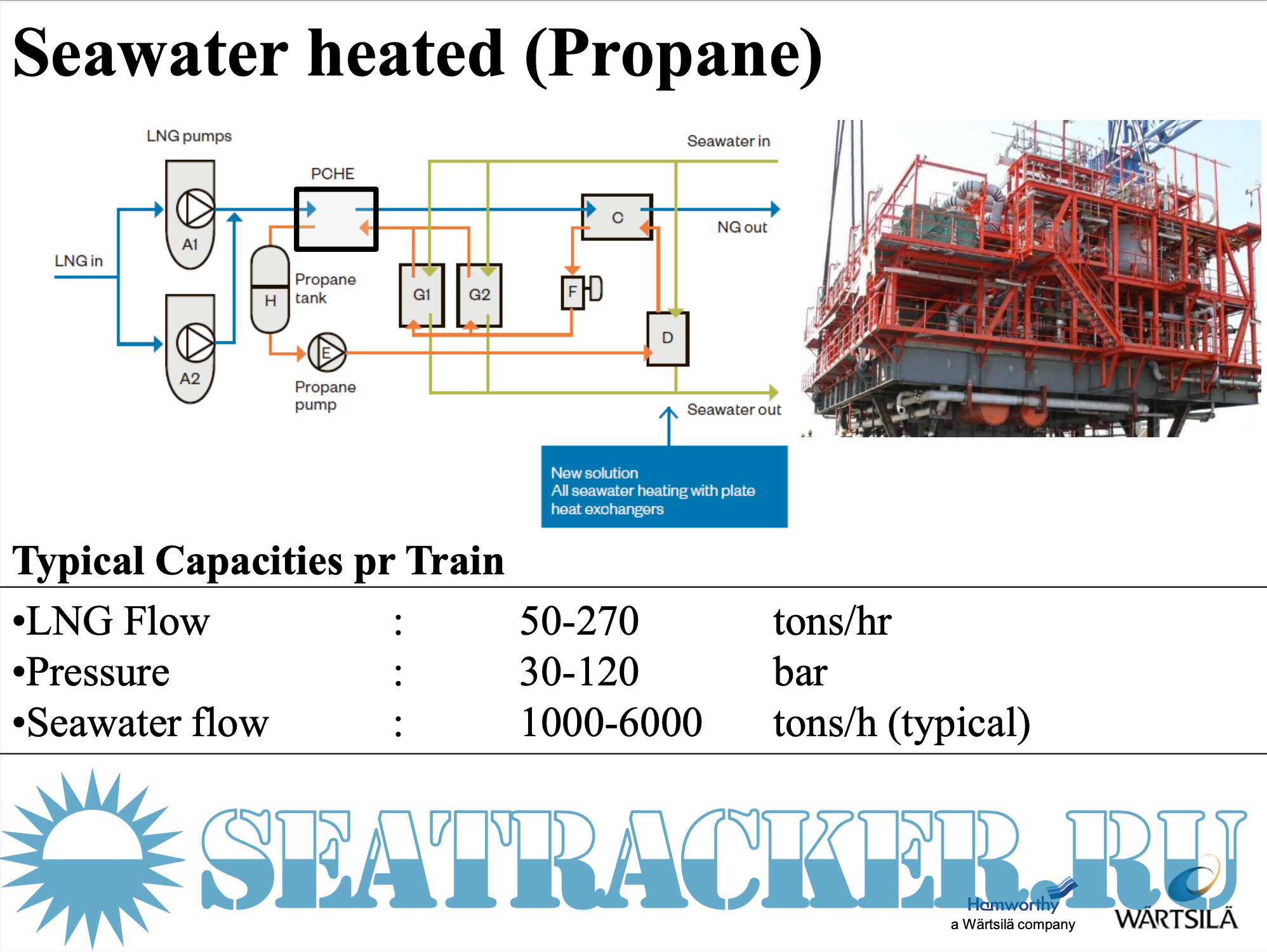

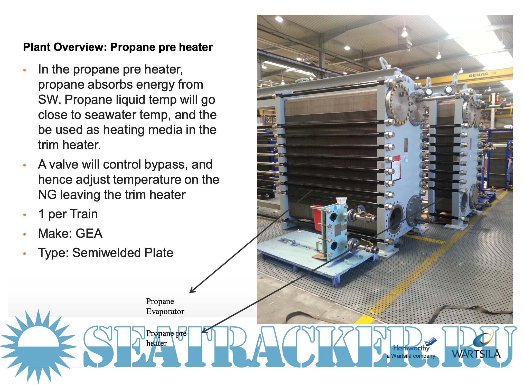

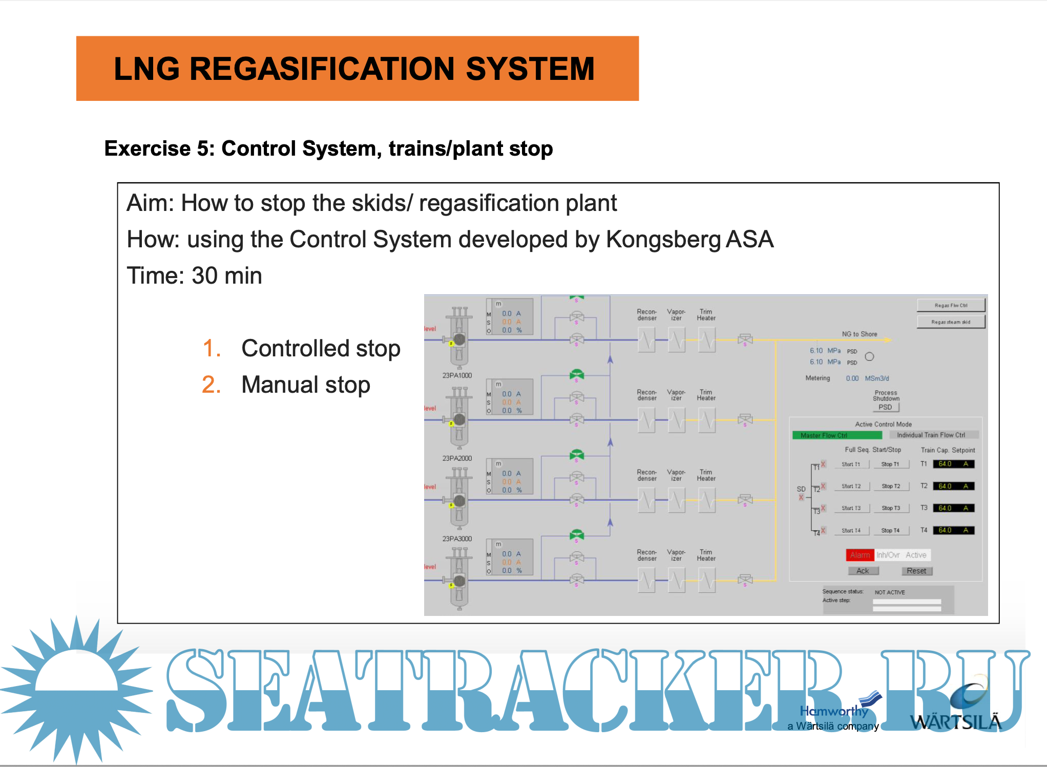

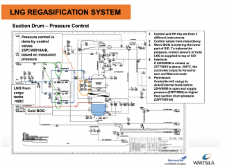

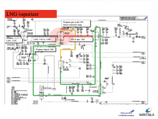

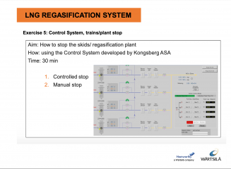

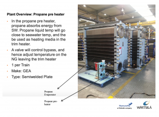

LNG (FSRU) Regasification System Seawater/Propane Operator Course
Year: 2013
Author: Hamworthy (Wartsila)
Number of pages: 241
Description: 3 day course for FSRU Regas Operators
Lesson 1 - Plant Overview
Lesson 2 - 3D Model Walkthrough
Lesson 3 - Control System Philosophy
Lesson 4 - Obtaining practical experience with Control System and Plant Start up and Shut Down
Lesson 5 - Pumps and main equipment knowledge and maintenance
FSRU Regas Hamworthy Manual
