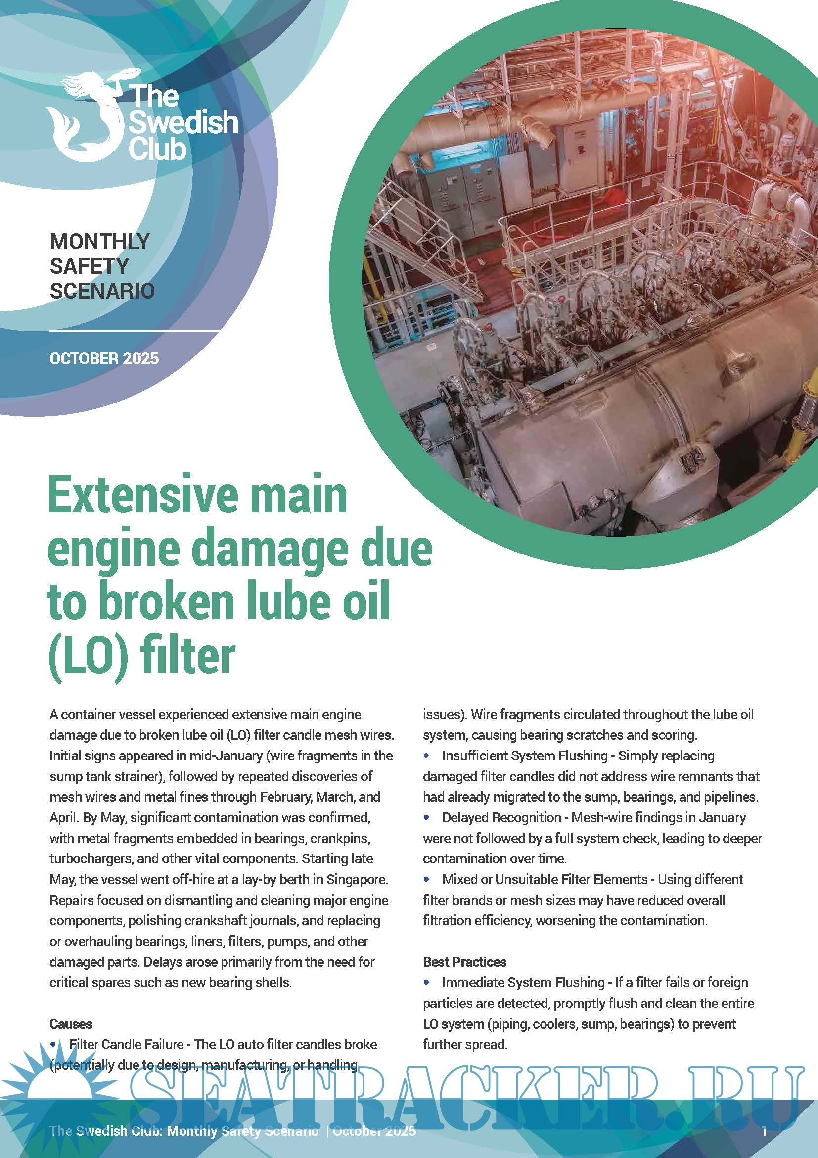

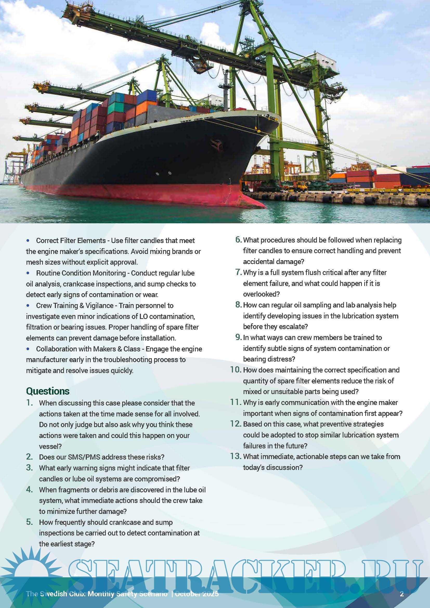

Issue October, 2025 | Extensive main engine damage due to broken lube oil (LO) filter. We look at a case where a container vessel suffered severe main engine damage caused by broken lube oil (LO) filter candle mesh wires. The scenario follows how early warning signs were detected but continued contamination led to widespread damage to bearings, crankpins, and other vital components eventually taking the vessel off-hire for extensive repairs in Singapore.
