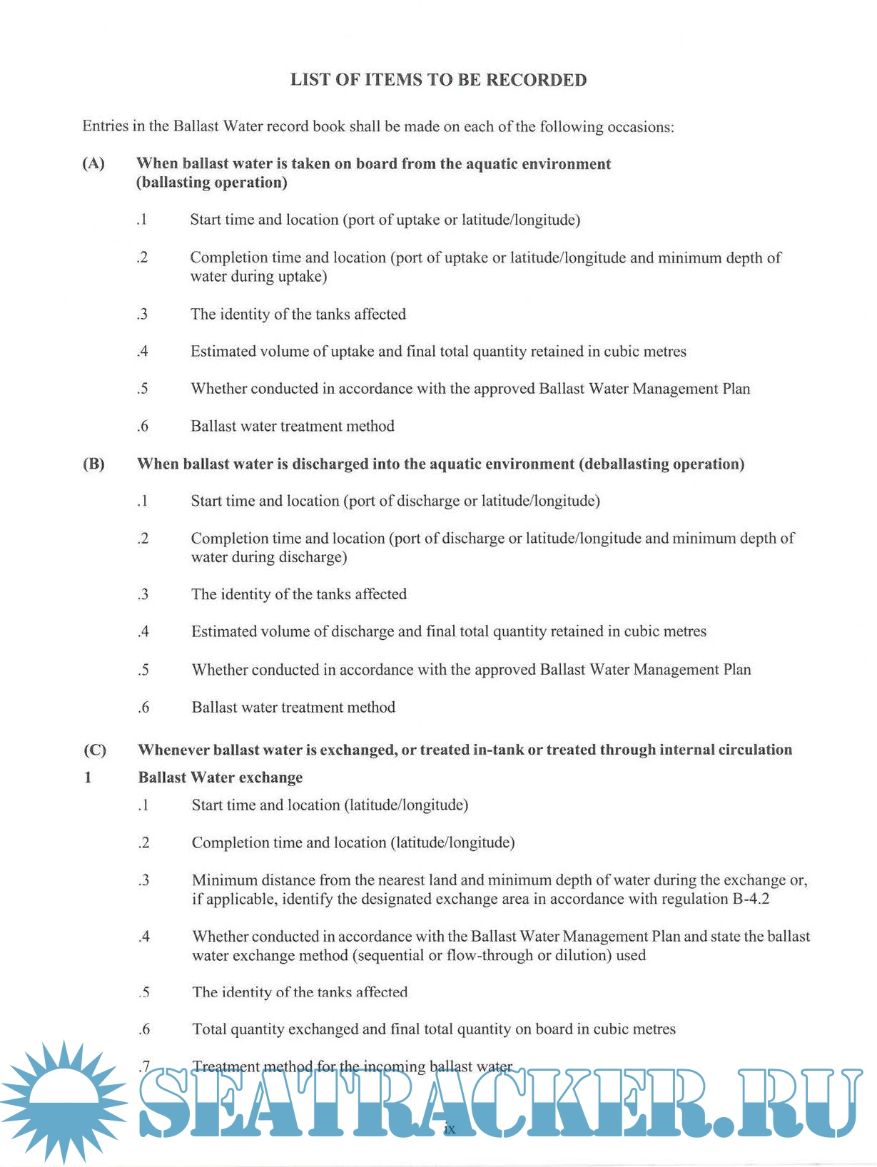

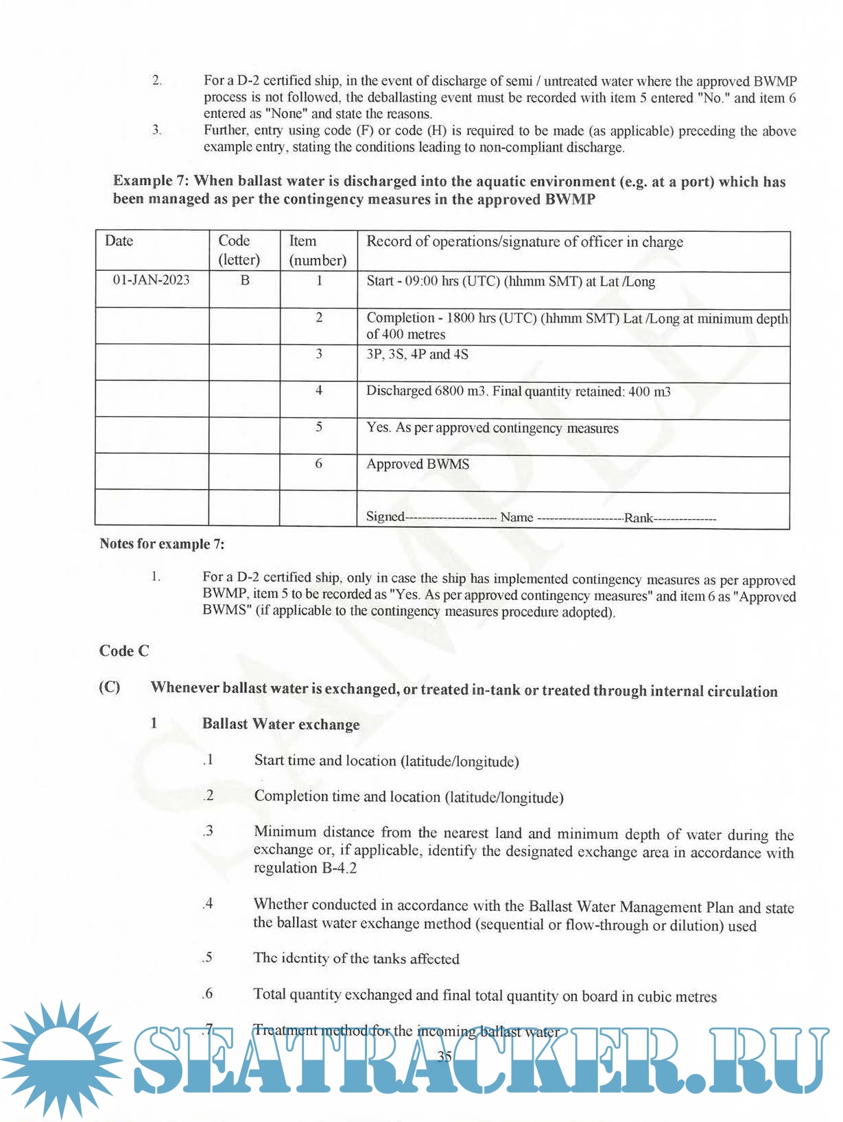

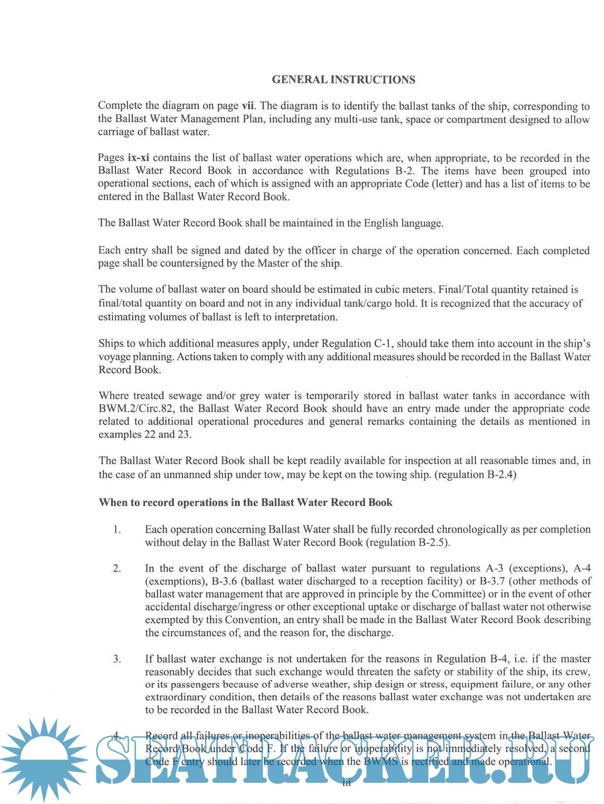

Ballast Water Record Book (see BWM-001) - Each ship to which the BWM Convention applies shall have on board a Ballast Water Record Book. Each operation concerning Ballast Water shall be fully recorded without delay in the Ballast Water Record Book. Ballast Water Record Book entries shall be maintained on board the ship for a minimum period of two years after the last entry has been made and thereafter in the Company's control for a minimum period of three years. This Ballast Water Record Book complies with Regulation B-2 of the BWM Convention and contains guidance on completing entries.
Together with the enclosed instructions, this is the Official Ballast Water Record Book of the Maritime Administrator. This Book has been designed so that it may be used by ALL ships for recording ballast water operations. In accordance with regulation 8-2 of the annex to the International Convention for the Control and Management of Ship's Ballast Water and Sediments, a record is to be kept of each ballast water operation. Each ship shall have on board a Ballast Water Record Book, that may be an electronic record book, or that may be integrated into another record book or system, and which shall at least contain the information specified in appendix II.

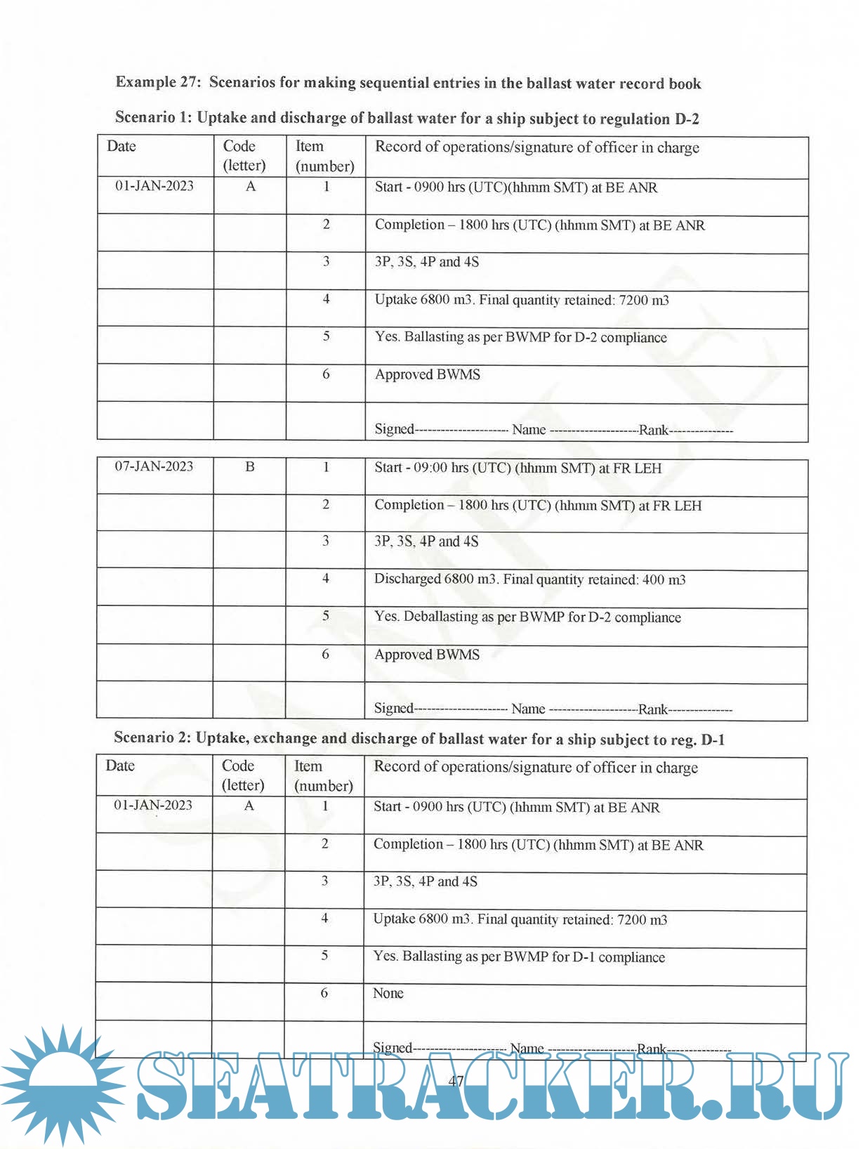

For guidance on how to fill out BWRB entries, refer to BWM.2/Circ.80/Rev.1 – Guidance on ballast water record-keeping and reporting. The BWM Convention has been amended by IMO resolution MEPC.369(80), which changes the format of BWRBs and has come into force on 1 February 2025.

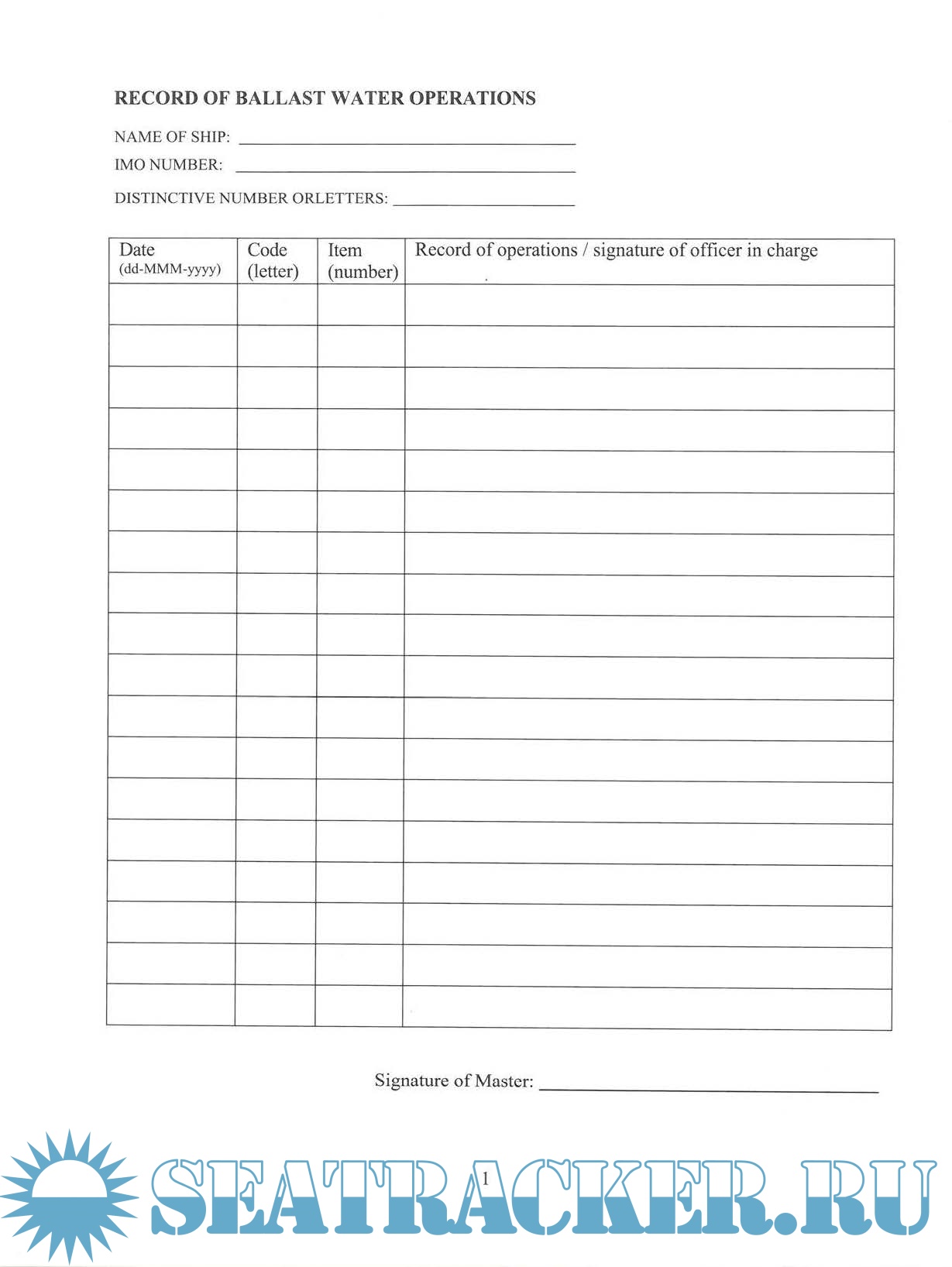

Additional info: Page number 1 named "RECORD OF BALLAST WATER OPERATIONS" must be printed 30 times to obtain the FULL volume of the document.
