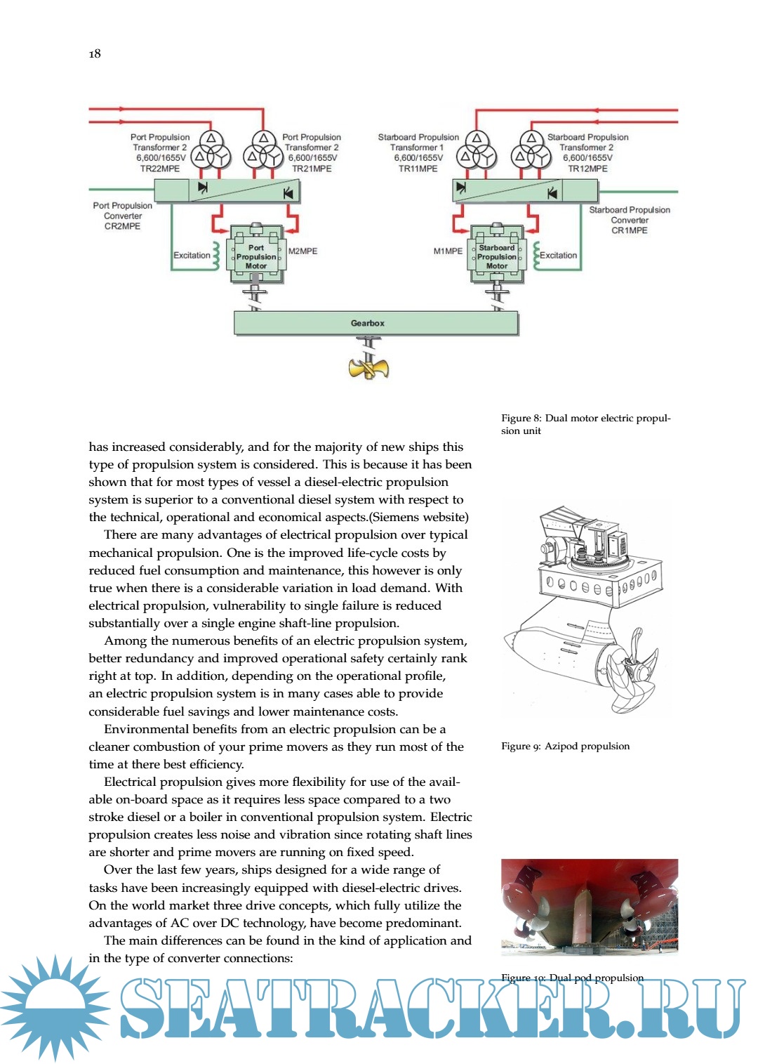

Shore to ship arrangements will increase in the future due to stricter port emission rules. Figure 2: Low voltage cable tray Why High Voltage on Board of Ships As the demand for electrical power increases on vessels the supply current ratings becomes too high for the usual 3 phase 440 V. To reduce the size of both steady state and fault current levels it is necessary to specify a higher power system voltage at the higher power ratings. In marine practice voltages below 1000 V are considered LV (low voltage). HV (high voltage) is any voltage above 1 KV. Typical marine HV system voltages are 3.3 KV and 6.6 KV. 11 KV Systems are emerging with the still increasing power demands. Low voltage side of the network the voltage levels are 440V, or 680V. By generating electrical power at 6.6 KV instead of 440 V the distribution and switching of power levels above about 6 MW becomes more practicable and manageable.
