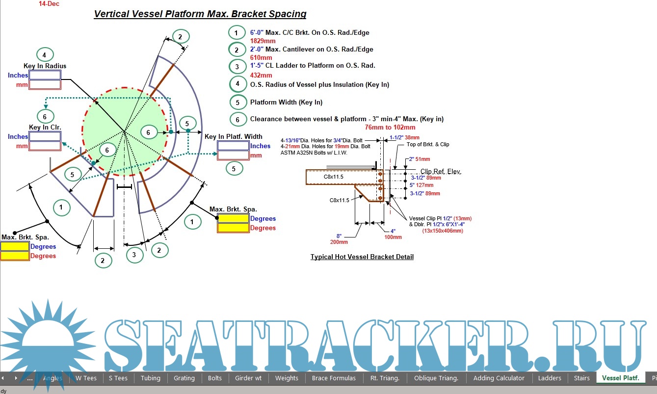

Engineering spread sheet for maritime engineers
Year: 2011
Author: Oil & Gas company
Genre: Convention (rules)
Format: XLS
Quality: Unknown
Pages count: various
Description: This spreadsheet has numerous useful codes, formula, information which are used everyday life of marine engineers.
Engineering_Spread_Sheet.xls
Download [4 KB]
