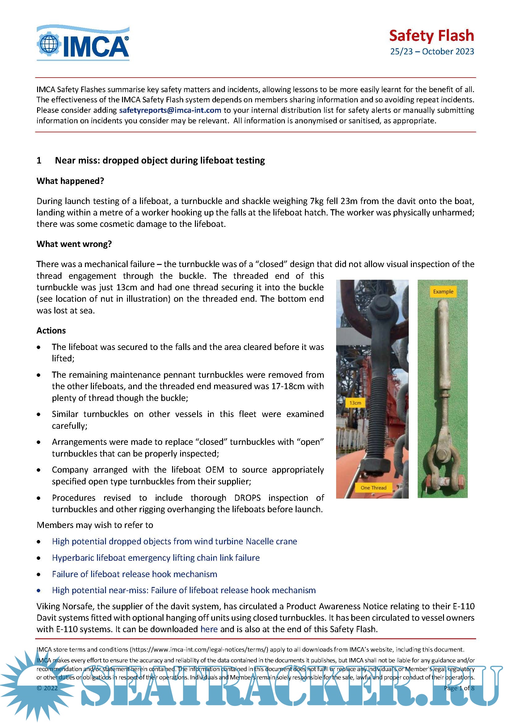

• Near miss: dropped object during lifeboat testing

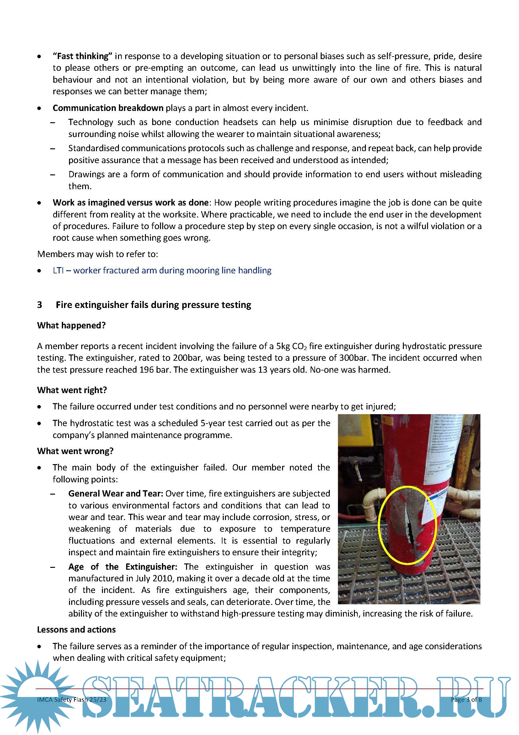

• Fire extinguisher fails during pressure testing
