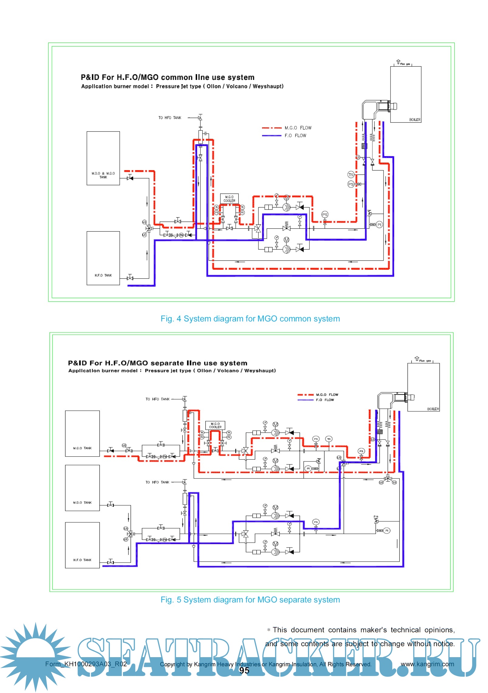

Piping System Diagram in E/R (Crude Oil Tanker , DWT 115, built in 2022, Korean Shipyard ) - DHSC…
