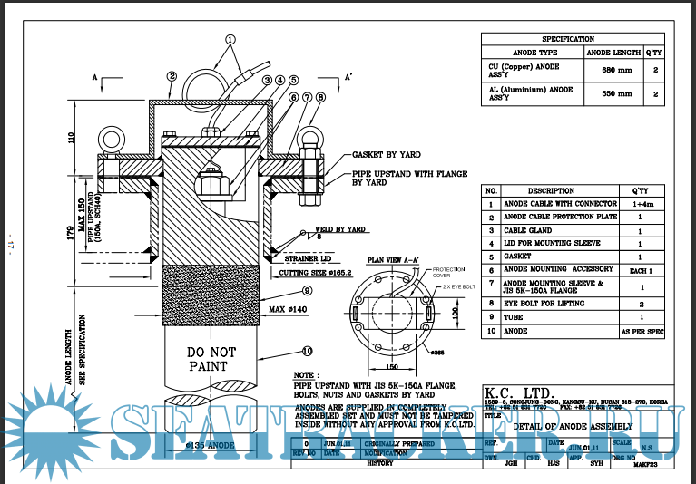

K.C. system is based on the electrolytic principle and consists of copper, aluminium and ferrous anodes which are fed with an impressed electrical current from a control panel.
The anode are usually mounted in pairs in the ship’s sea chest or strainer where they are in direct contact with the flow of water entering the seawater lines.
Also the anodes can be mounted on independent treatment tank for other convenience.
