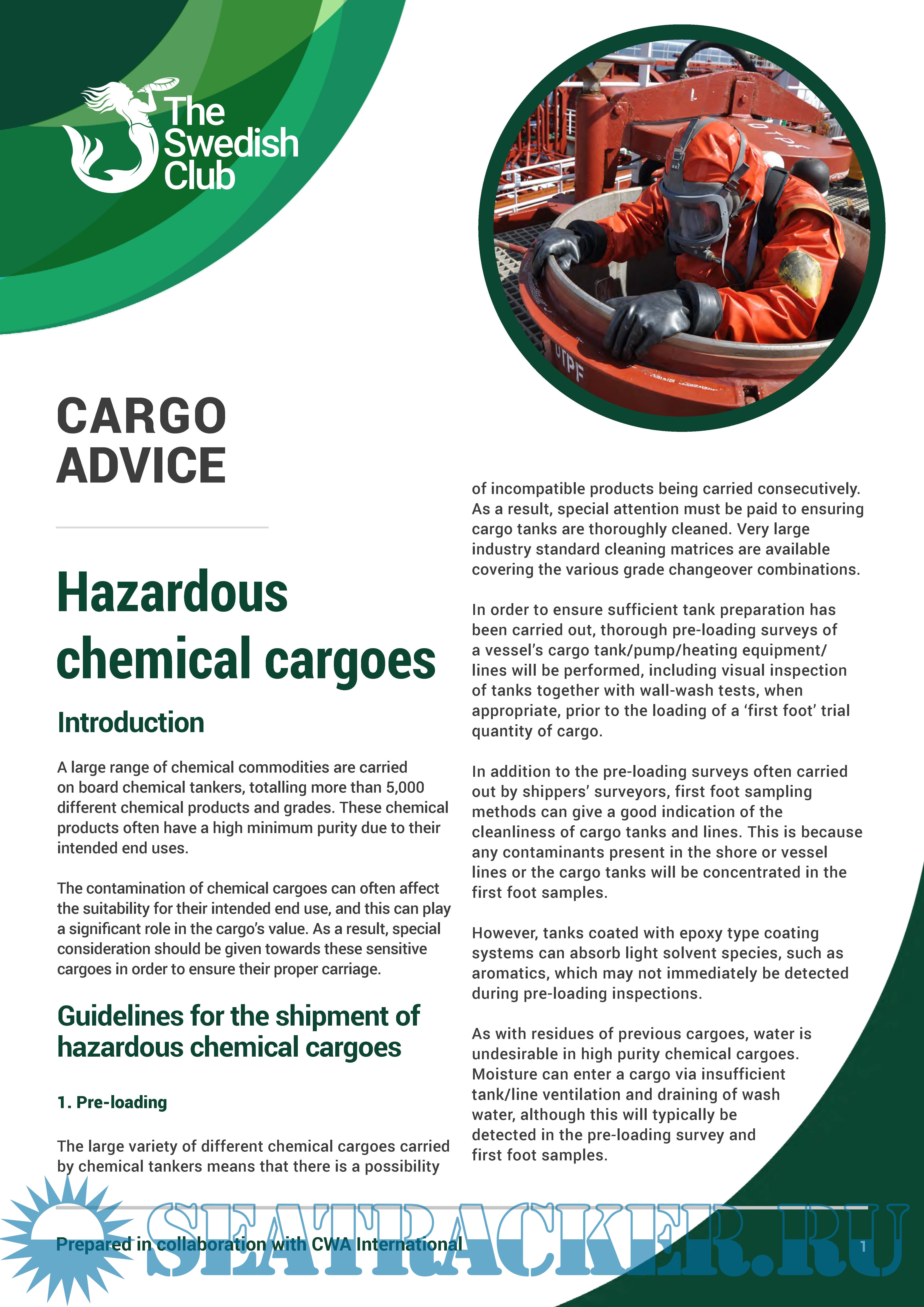

Description: Cargo advice Guide, focusing on Hazardous Chemicals shipment.
A large range of chemical commodities are carried on board chemical tankers, totalling more than 5,000
different chemical products and grades. These chemical products often have a high minimum purity due to their
intended end uses.
The contamination of chemical cargoes can often affect the suitability for their intended end use, and this can play
a significant role in the cargo’s value. As a result, special consideration should be given towards these sensitive
cargoes in order to ensure their proper carriage.
