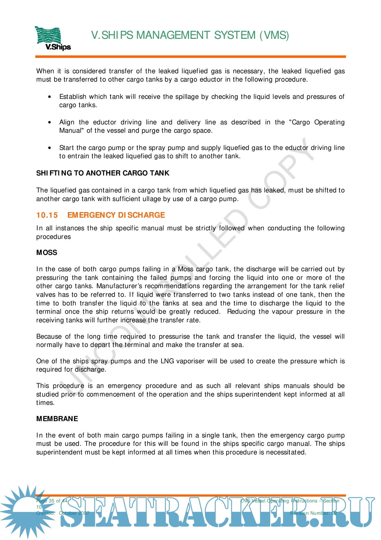

VMS - LNG VESSEL OPERATING INSTRUCTIONS
Year: 2007
Author: V.SHIPS MANAGEMENT SYSTEM (VMS)
Pages count: 197
Description: This Manual is issued in accordance with the Company's VMS and contains specific
instructions etc. based on V Ships operating experience.
The subject matter was selected where the Company considered that emphasis had to be
placed on the relevant operational procedures, precautions, instructions etc.
It is the policy of V.Ships, that all cargo operations are carried out in a controlled and safe
manner in accordance with Company operating procedures as laid down in the V.Ships
Safety Management System. These procedures are based on industry best practices as
referenced in the publications listed in this manual.
The following procedures are intended to lay down minimum standards and to serve as
guidelines for the safe operation of the vessel. Should there be any conflict between the
procedures and diagrams in this manual, and those in the ship specific cargo operating
manuals, then the cargo operating manual is to take precedence.
