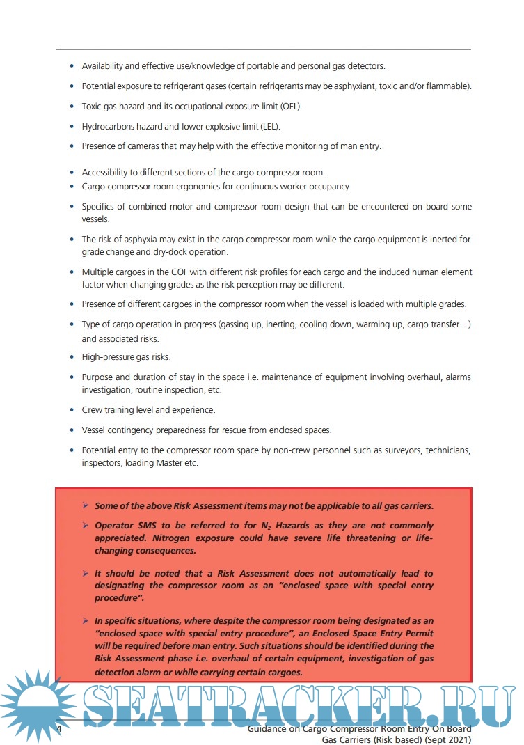

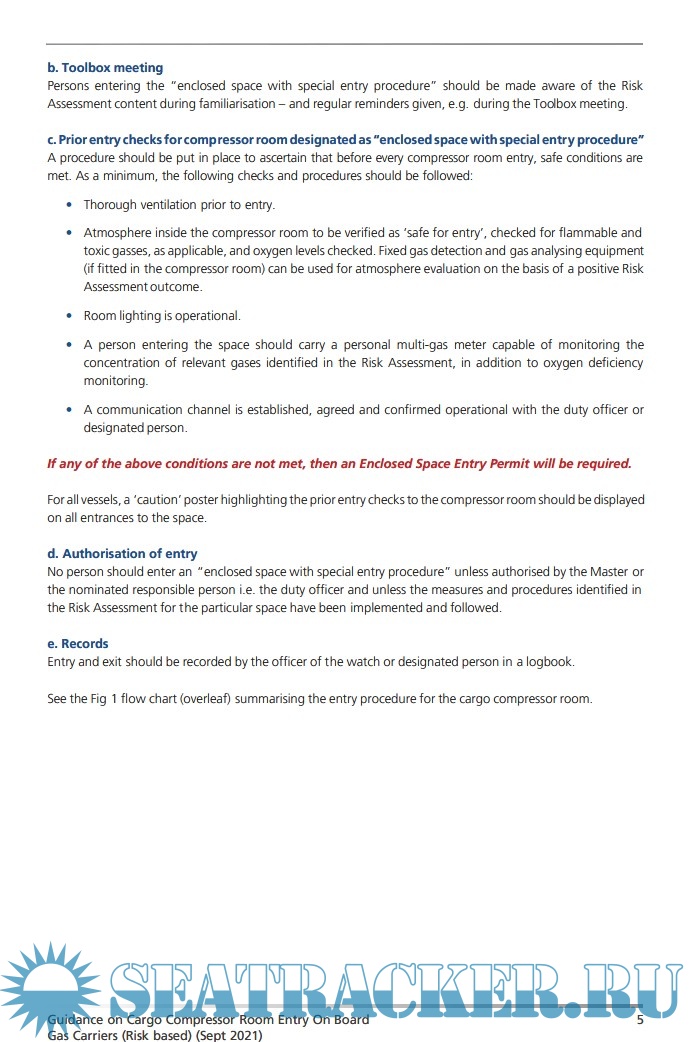

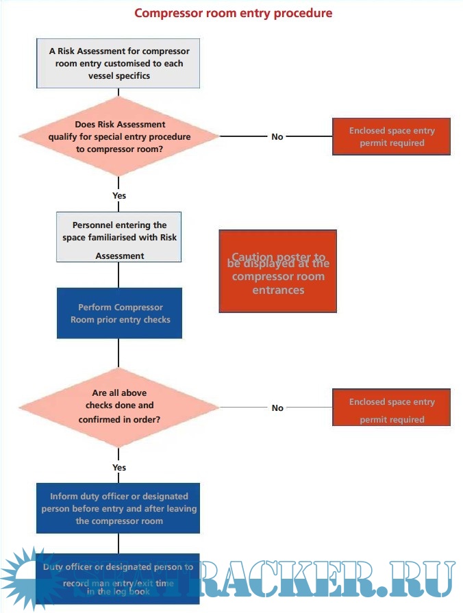

Description: Recognising the safety benefits of the existing mandatory requirements for ventilation, openings for entry and exits, and gas detection system applicable to compressor rooms design and features, this document provides advice on the safety measures to be put in place when entering cargo compressor rooms that have been risk assessed for entry without the need for an Enclosed Space Entry Permit, in the framework of a special entry procedure.
This risk-based procedure will help align best practice amongst gas vessel operators for compressor room entry and is also aiming to become a reference for IMO works related to enclosed space entry.
The risk assessment outcome is at the heart of this guidance, as such some compressor rooms may not be entitled to the special entry procedure.
Additional info: The requirement for routine access to cargo compressor rooms on board has meant that the daily issuance of
an Enclosed Space Entry Permit to this space could increase paperwork and also dilute the safety culture of
the crew on board.
This Guidance proposes a risk-based method to control compressor room entry without lowering safety
standards.
