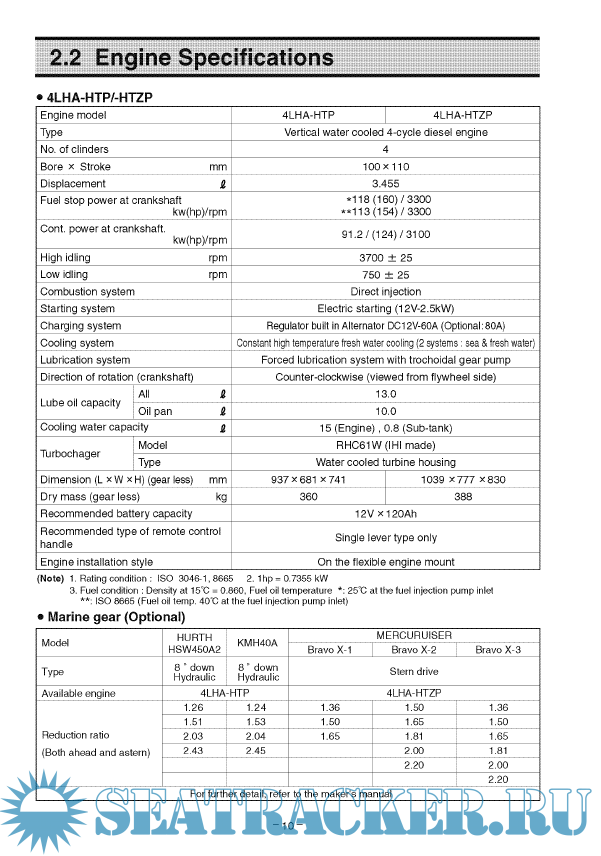

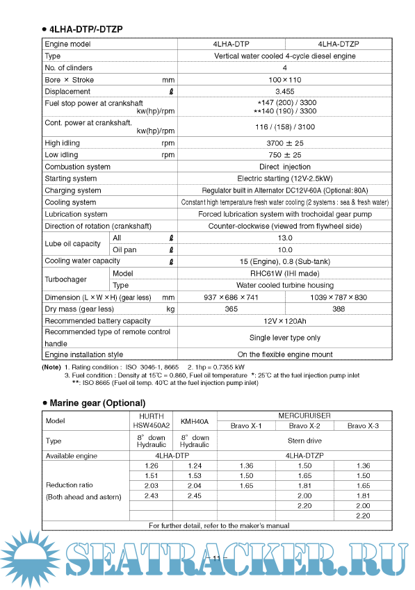

Specifications
Rated Output - 177 kW / 240 mhp
Rated Speed - 3300 rpm
Displacement - 3.455 L / 211 cu. in
No. of cylinders - 4 cylinders
Cylinder Bore x Stroke - 100 mm x 110 mm / 3.94 in x 4.33 in
Combustion system -Direct Injection, In-line Pump
Aspiration - Turbocharged & Intercooled
Alternator - 12V - 80A
Dry weight without gear - 365 kg / 805 lbs
Dimensions - 1131 mm x 719 mm x 811 mm
Controls - Mechanical
