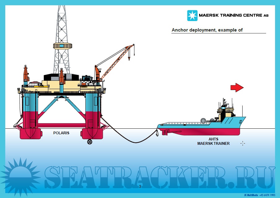

1. Program. Abbreviations Introduction to Anchor Handling Course
2. Risk Assessment. Planning
3. Calculations: Winch, Weight, Catenary
4. Anchor Deployment – PCP. Example of…
5. AH – Winches. Winch Computers. Wire Drums. Chain Wheels

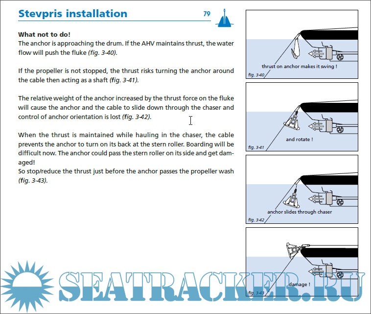

12. Vryhof Anchor Manual 2005
13. Anchor Handling Breaking the anchor…..
