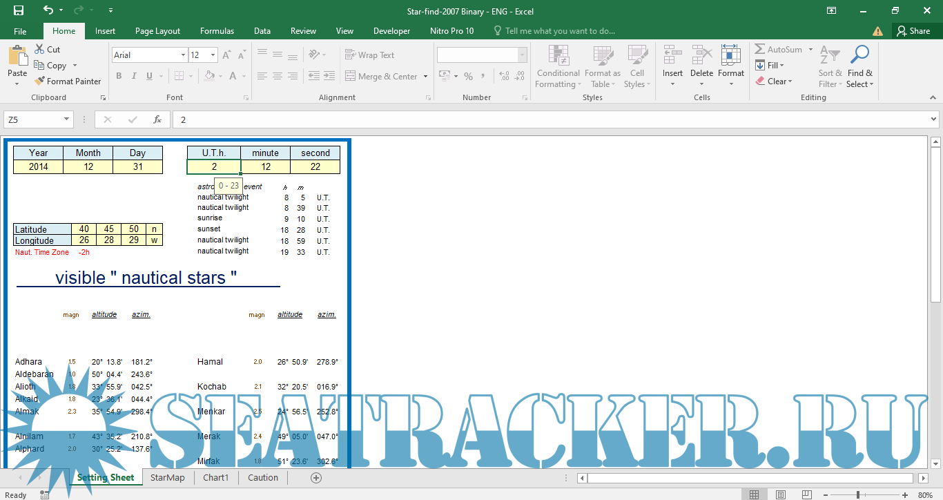

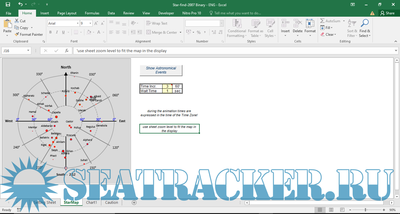

It is necessary to identify the star, with the binoculars of the sextant, when it is not yet possible to the naked eye. To make this happen it is necessary to set the height of the celestial body on the sextant with a certain precision. This can only happen if you are using a Starfinder; this made in excel is of absolute precision.
In order to determine in advance the heights and azimuths of the stars, the navigator in recent decades has used traditional instruments such as the Del Pino spheroscope or the Starfinder 2102-D. The first, no longer on the market, guaranteed good accuracy of the data: the maximum difference between the indicated height and the actual one was about 2.5 degrees in the most unfavorable case. Therefore it was always possible to quickly locate the star in the sky. Using the Star-Finder 2102-D the maximum deviation inevitably rises to 5 degrees!
It is also for this reason that the “StarFinder” was created in an excel and free version: the accuracy of the data is close to 0.1 '. The heights and azimuths indicated in the file are nothing more than the estimated height and azimuth that are obtained at the end of the laborious calculations that follow the astronomical observation!
