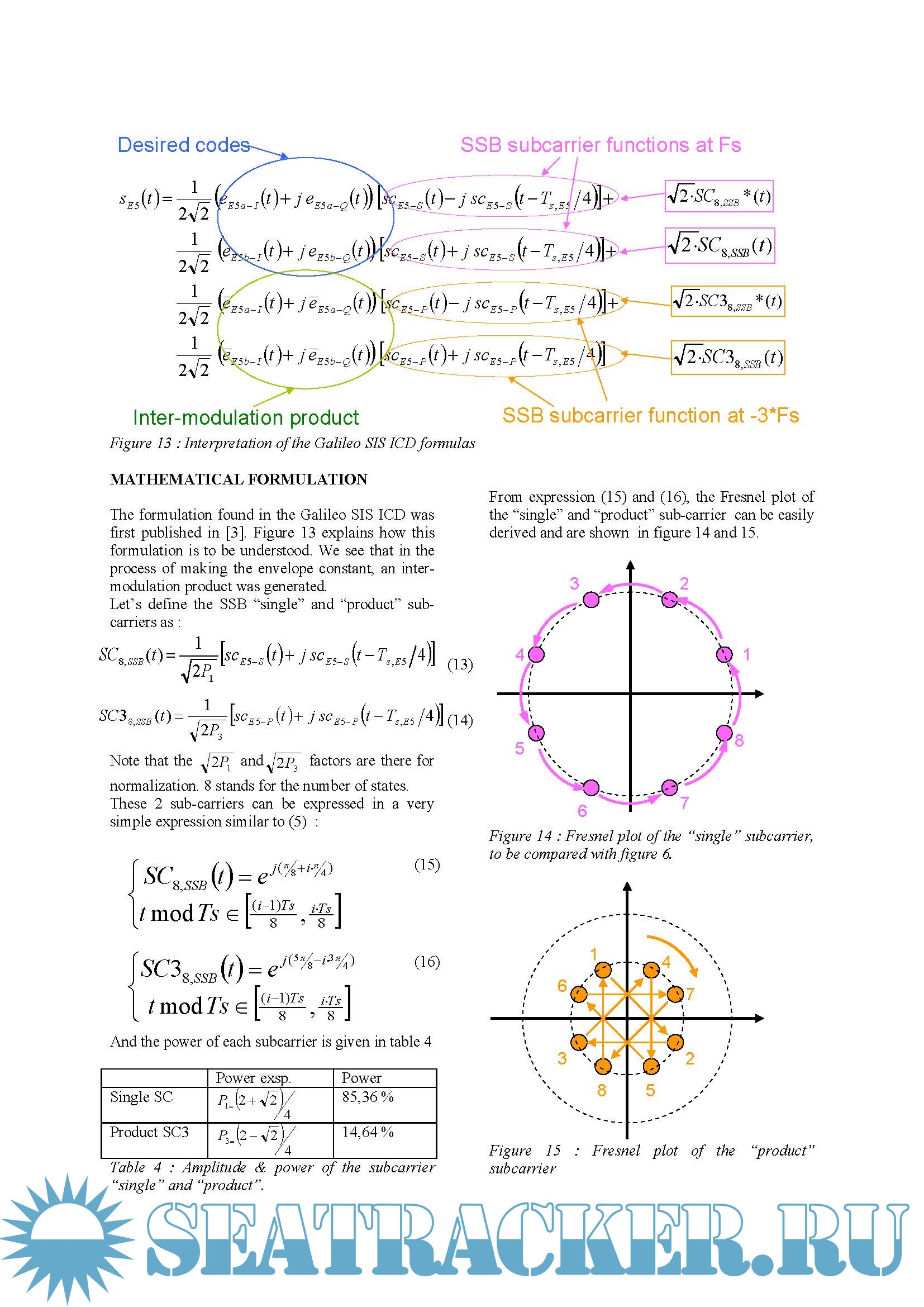

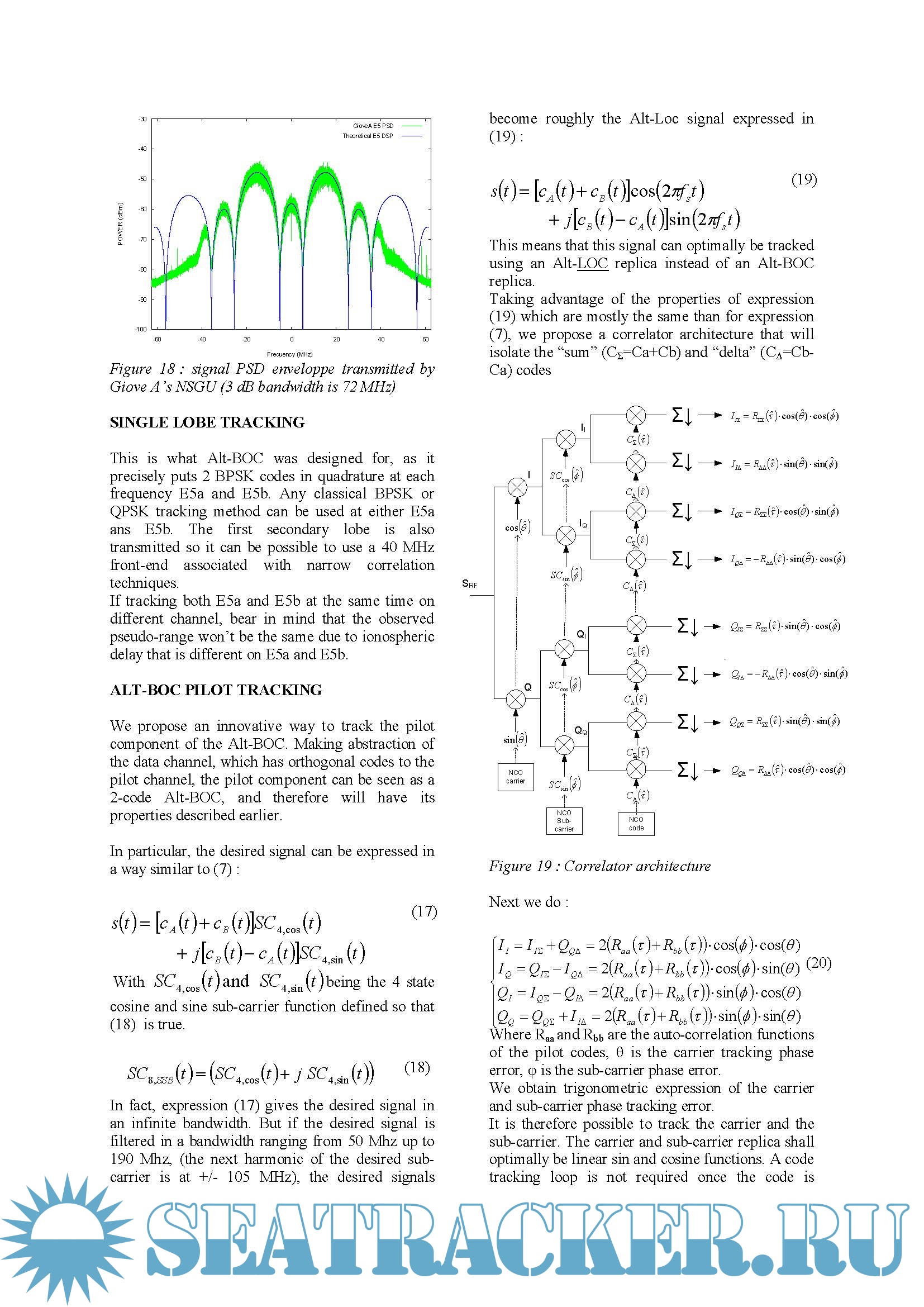

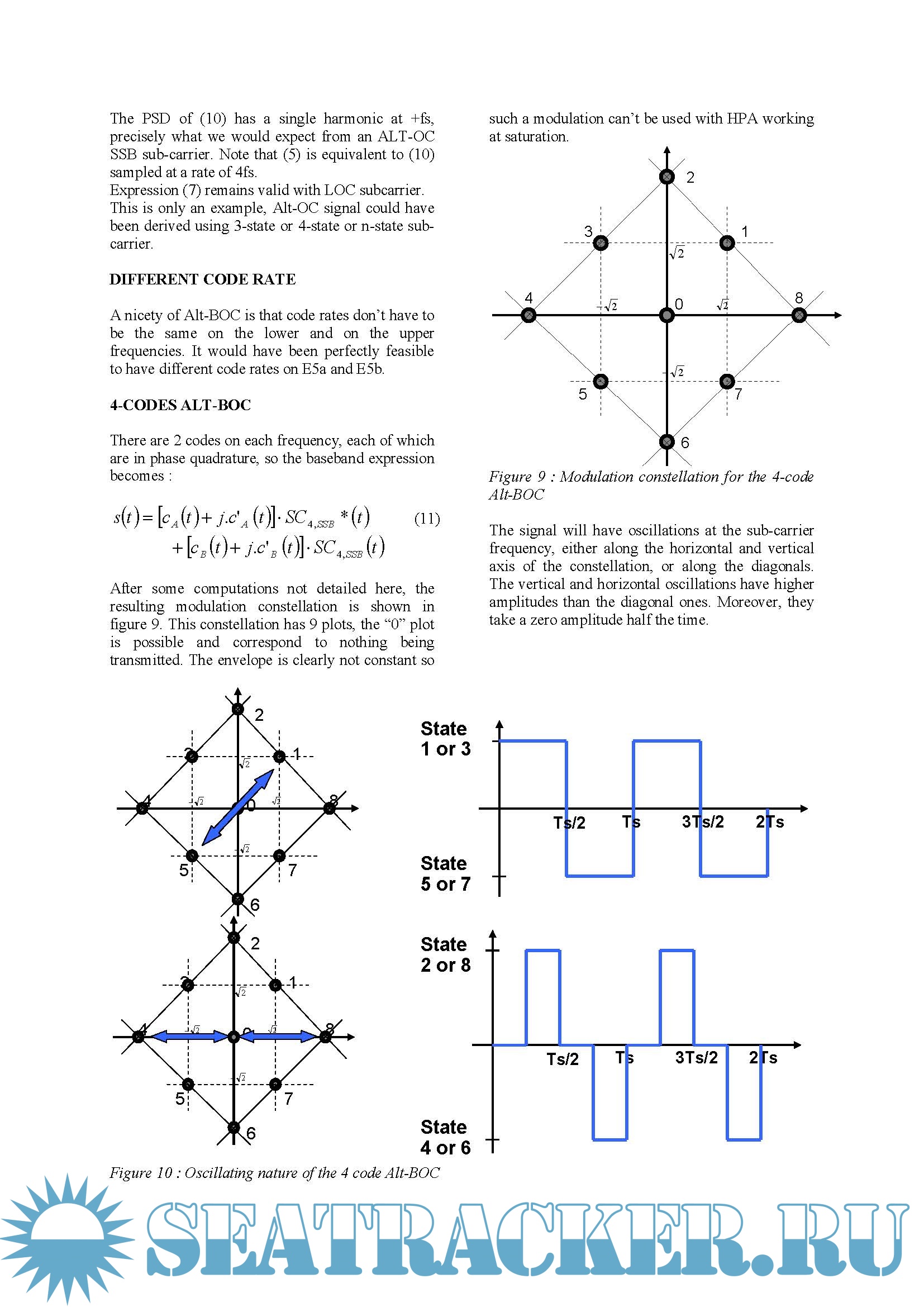

AltBOC for Dummies or Everything You Always Wanted to Know About AltBOC
Year: 2008
Author: Laurent Lestarquit, CNES
Genre: Technical book
Pages count: 10
Description: Alt-BOC is a modulation whose understanding require strong efforts. The mathematical formulation and the equivalent look-up table provided in the GALILEO SIS-ICD are not strait-forward. Written by its inventor, the purpose of this paper, is to help navigation engineers in understanding Alt-BOC or we should say, understanding the numerous Alt-BOC variants, explaining how the constant envelope Alt-BOC was invented, and highlighting its properties. An accurate definition was given in : “ An Alternative-BOC signal is a BOC-like signal having different PN codes in the lower and the upper main split lobes. Alternative-BOCs allow one signal service per lobe.”
See Screenshots
