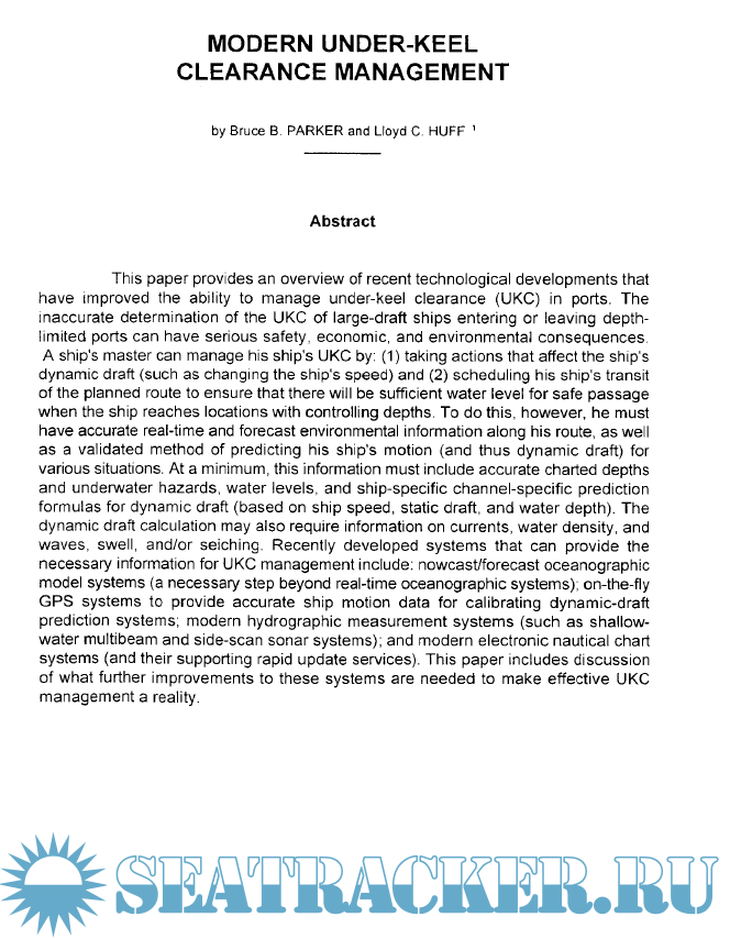

This paper provides an overview of recent technological developments that
have improved the ability to manage under-keel clearance (UKC) in ports. The
inaccurate determination of the UKC of large-draft ships entering or leaving depthlimited
ports can have serious safety, economic, and environmental consequences.

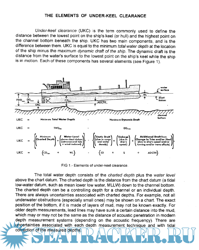

A ship's master can manage his ship's UKC by: (1 ) taking actions that affect the ship's
dynamic draft (such as changing the ship's speed) and (2) scheduling his ship's transit
of the planned route to ensure that there will be sufficient water level for safe passage
when the ship reaches locations with controlling depths. To do this, however, he must
have accurate real-time and forecast environmental information along his route, as well
as a validated method of predicting his ship's motion (and thus dynamic draft) for
various situations. At a minimum, this information must include accurate charted depths
and underwater hazards, water levels, and ship-specific channel-specific prediction
formulas for dynamic draft (based on ship speed, static draft, and water depth). The
dynamic draft calculation may also require information on currents, water density, and

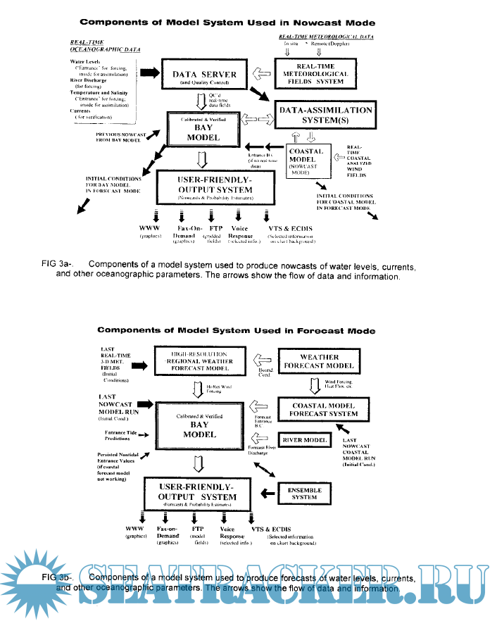

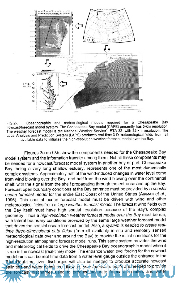

waves, swell, and/or seiching. Recently developed systems that can provide the
necessary information for UKC management include: nowcast/forecast oceanographic
model systems (a necessary step beyond real-time oceanographic systems); on-the-fly
GPS systems to provide accurate ship motion data for calibrating dynamic-draft
prediction systems; modern hydrographic measurement systems (such as shallowwater
multibeam and side-scan sonar systems); and modern electronic nautical chart
systems (and their supporting rapid update services). This paper includes discussion
of what further improvements to these systems are needed to make effective UKC
management a reality.
