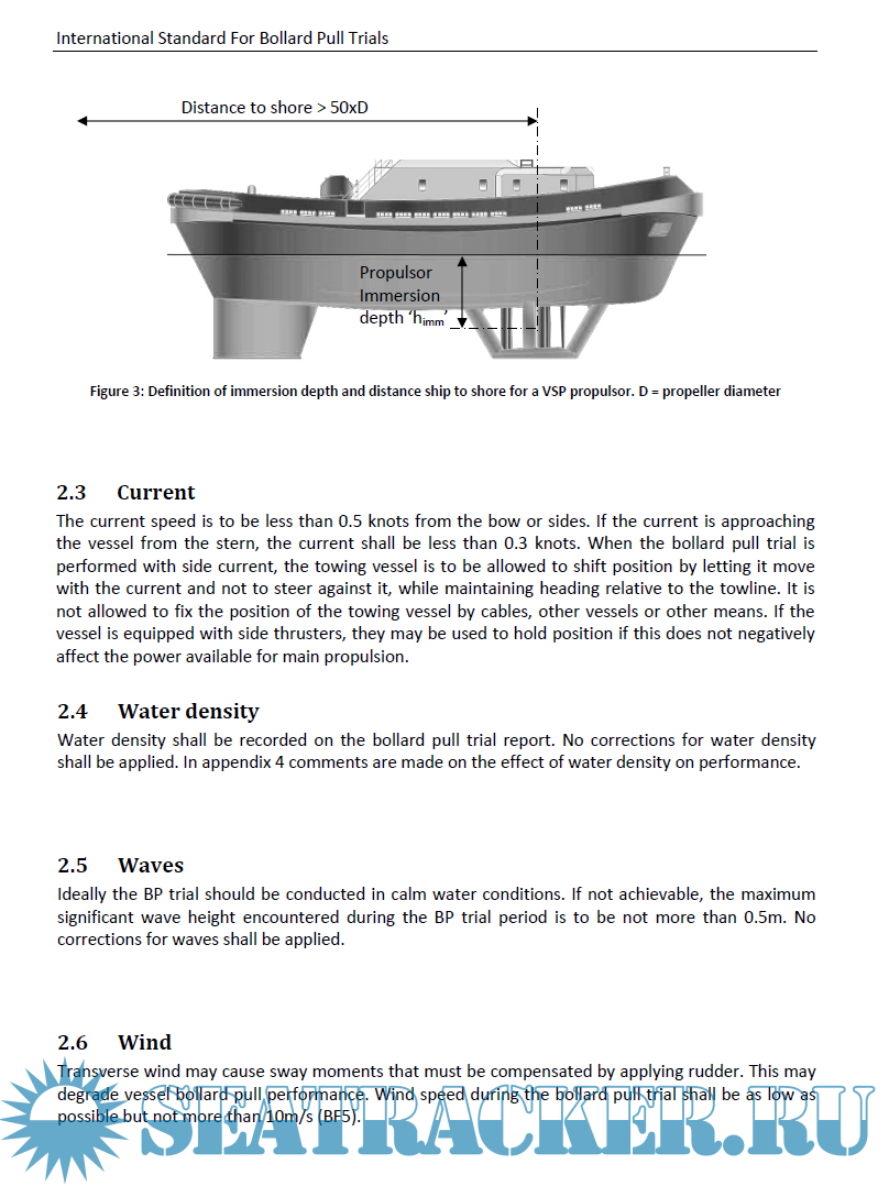

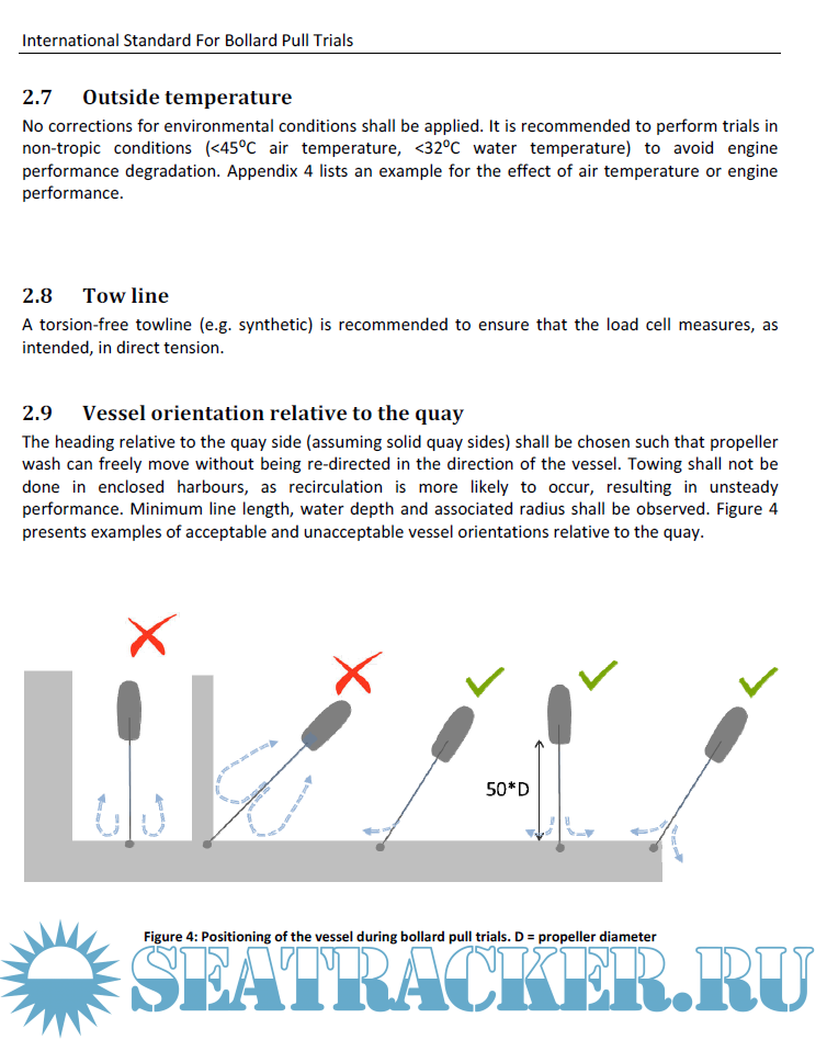

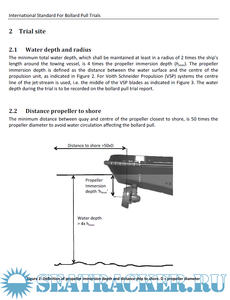

Description: This standard has been developed by the ‘Bollard Pull Joint Industry Project’ members over a 3 year
period. The Bollard Pull JIP consists of an international group of 31 industry representatives including
ship yards, operators, design offices, classification societies, engine and propeller manufacturers and
research institutes.
The standard has the purpose to ensure that the reported bollard pull figure represents the realistic
performance of the vessel that can be met in service conditions at an acceptable level of accuracy,
irrespective of the specific conditions met during the execution of the bollard pull trial that are
known to affect the vessel’s performance. This standard facilitates a repeatable performance figure
in accordance with clear definitions. Based on the research carried out in the project the procedure
expects to achieve an uncertainty of ±3% of the measured towline force.
The definitions, boundary conditions, environmental conditions, and analysis methodology for the
recording of certified Bollard Pull of marine vessels have been derived based on model testing, CFD
analysis, full scale validation campaigns and input from a team of specialists.
