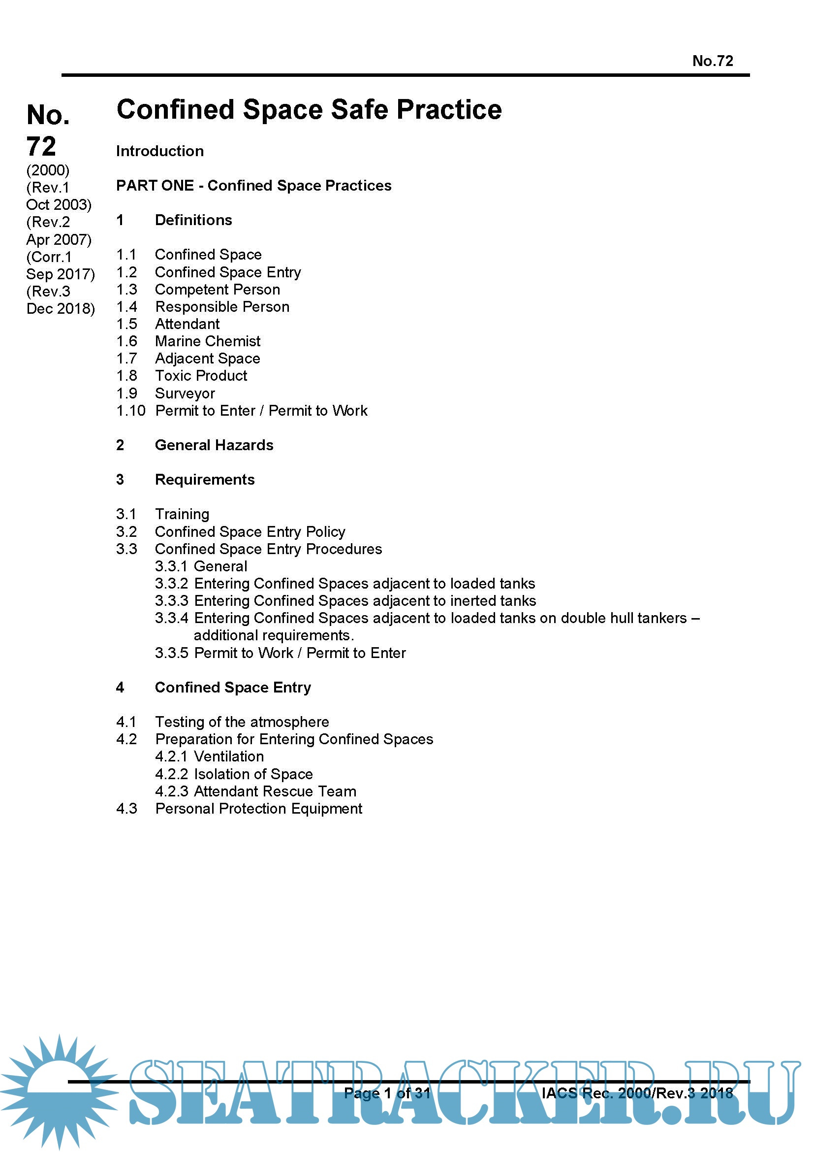

Confined Space Safe Practice, Rev. 3
Author: IACS
Pages count: 32
Description: This Guideline is intended to assist Societies in developing Confined Space Entry
procedures or technical instructions for the Surveyors, according to a common reference
standard of good practice.

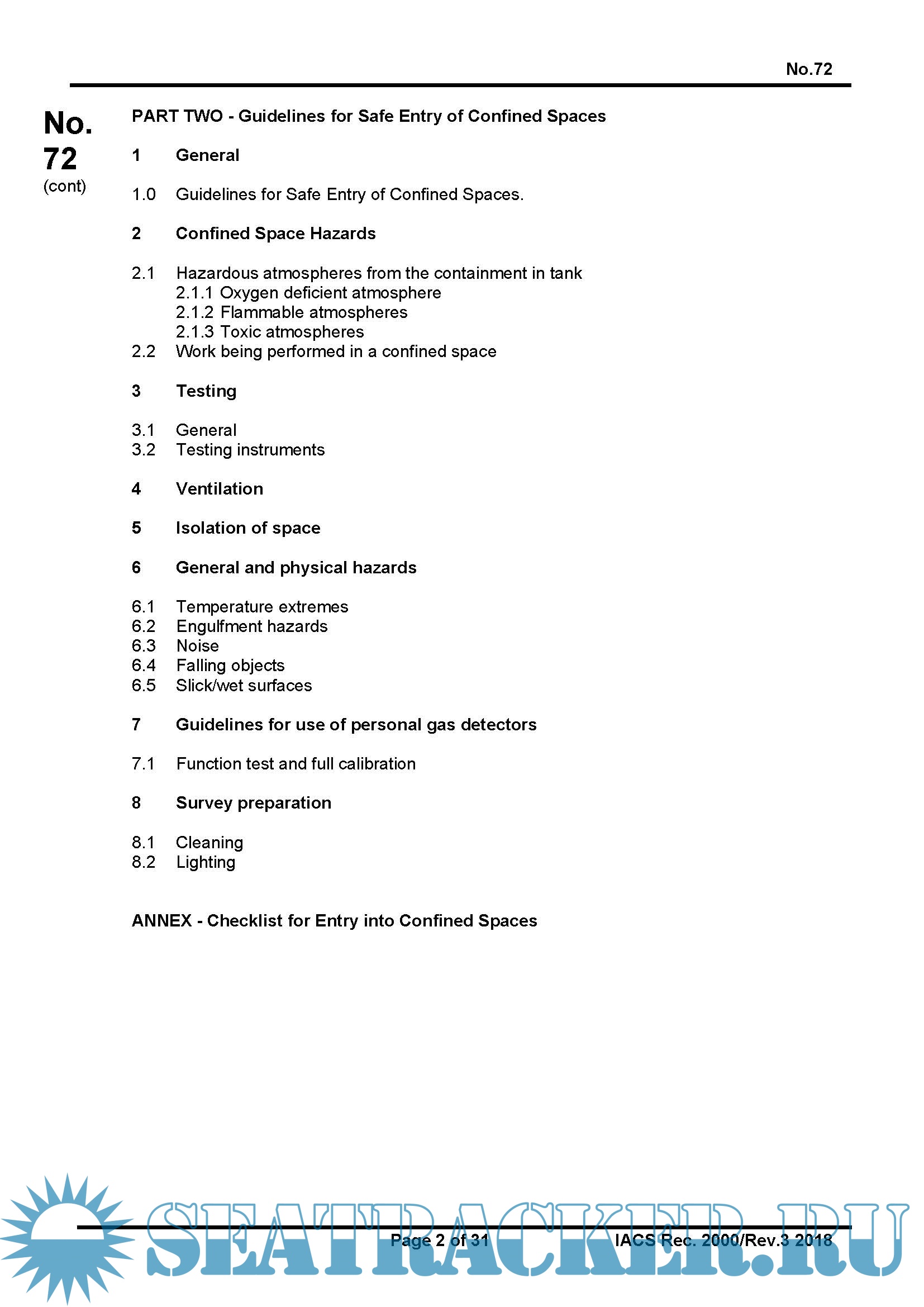

The Guideline is structured in two parts. In the first part, general information concerning
definitions and requirements to safely enter and work in Confined Spaces are summarized.
The second part helps the worker to recognize the hazards associated with confined spaces
and gives detailed guidelines for a safe survey preparation and entry.
A Checklist for Entry into Confined Space is also included.
