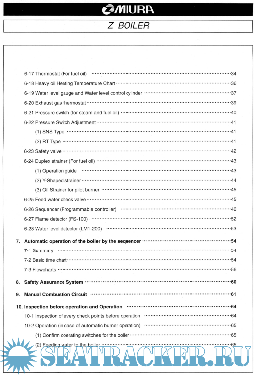

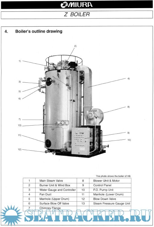

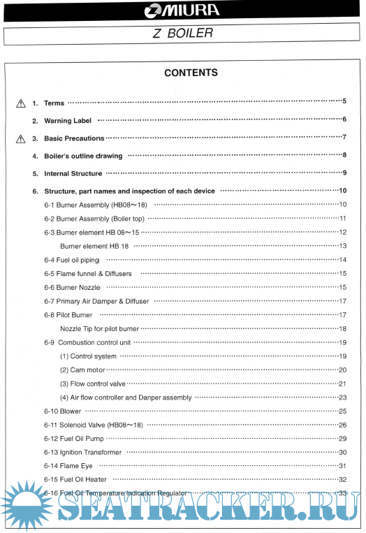

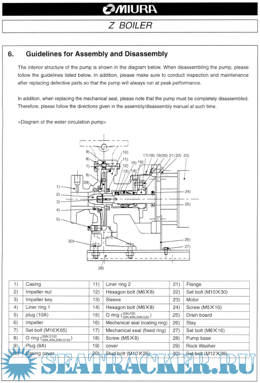

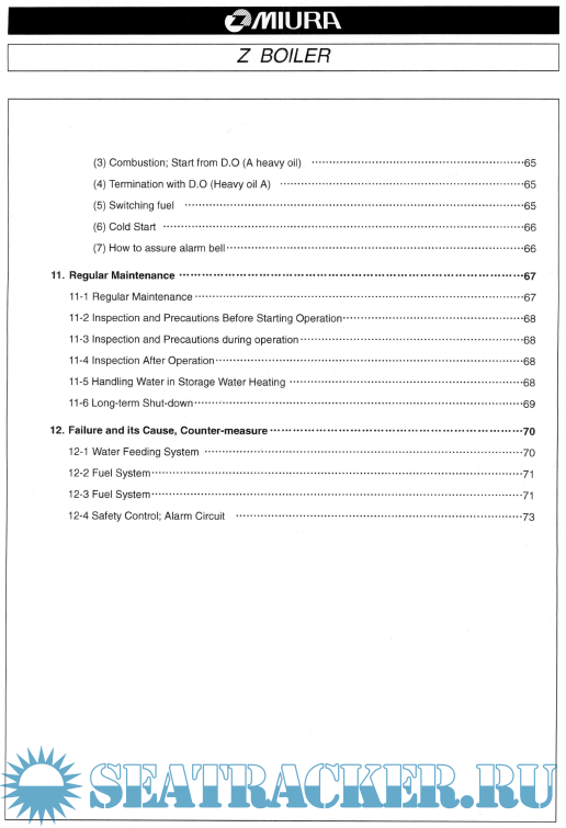

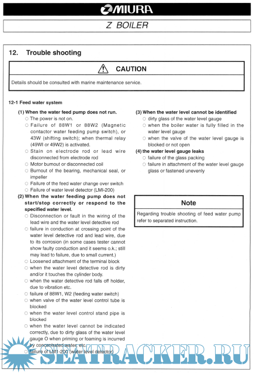

Auxiliary Boiler H_Type Z_Boiler Instruction Manual
Year: 2006
Author: MIURA CO.LTD
Pages count: 607
Description: This manual gives you instructions on how to use the Z-Boiler. In using the boiler, make sure you choose a person in charge of handling the boiler (Engineer) and use the boiler after perusing the manual and understanding the contents. In addition, we recommend that you always have this manual at hand when you work.
The main contents of this manual are: Outline of HB-type Z-Boiler, main functions, descriptions of the control system, operating procedure and maintenance. Precautions relating to operating method and safety indicated in this manual from damages to measures only relate to usage for specified purposes.
