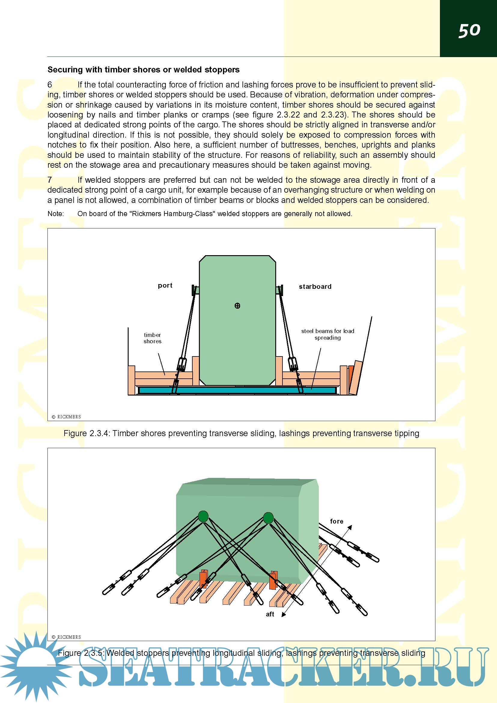

The Standard, in particular, provides detailed information about lifting, bedding and securing/lashing of cargo as well as the equipment used and its maintenance.

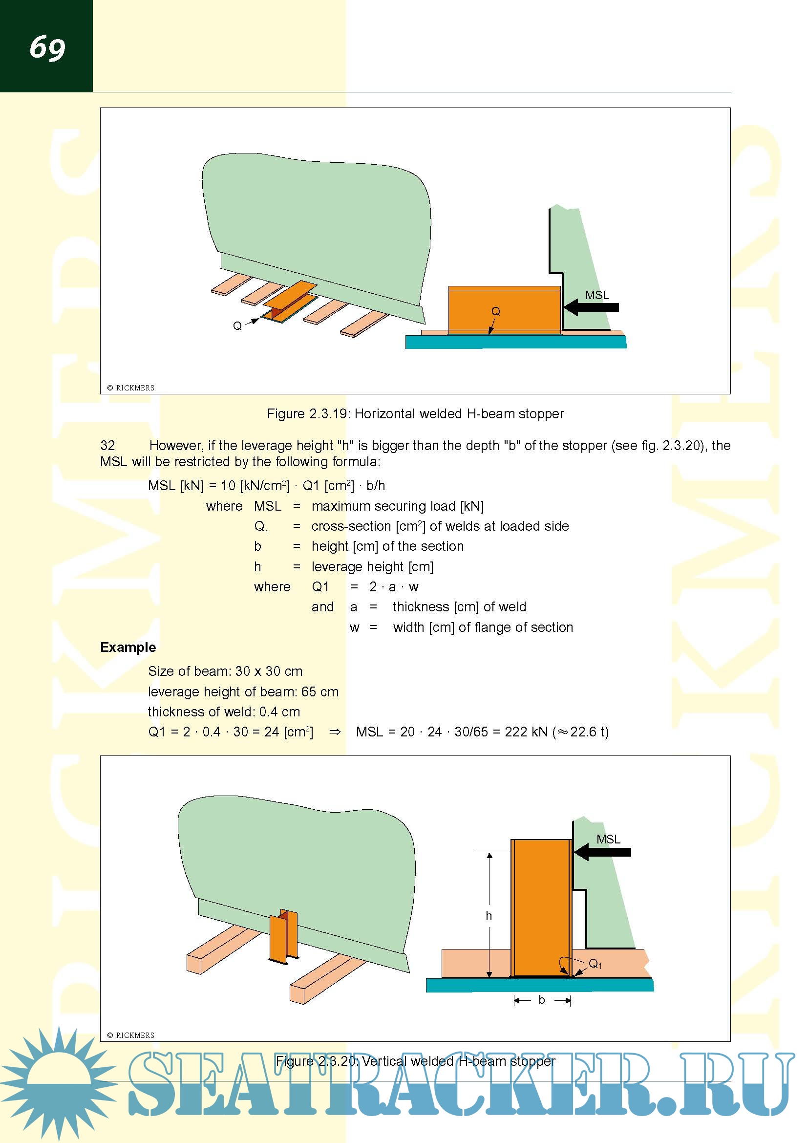

The Standard further describes the cargo information to be supplied by shippers in accordance with Chapter VI, Regulation 2 of the SOLAS-Convention (see Ch 1.3) and the necessary configuration of lifting provisions, bedding areas and securing points. The desired securing point configuration and lashing scheme of the cargo corresponds with the tensile strength (MSL as per IMO) of the fixed and loose securing gear on board of the vessels and their deck lay-out.
