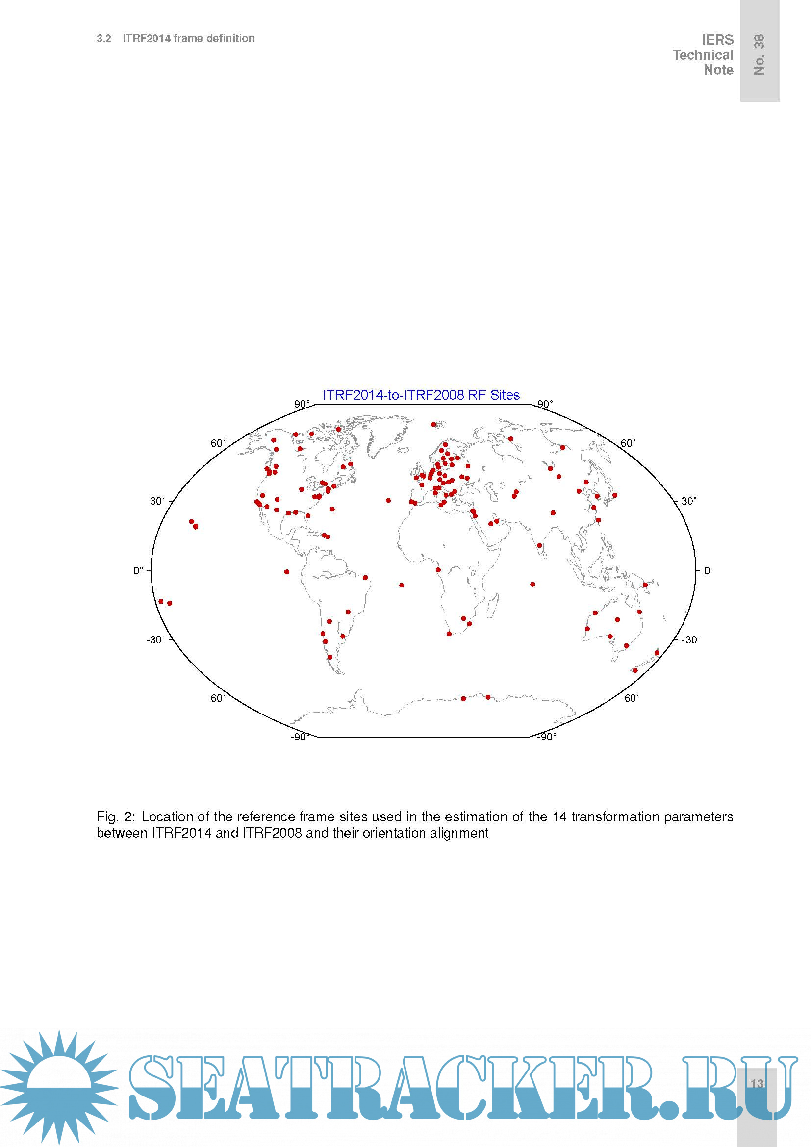

The ITRF2014 includes the positions and velocities of 1499 stations
located at 975 sites. Figure 1 shows the coverage of these sites, underlying
the co-located space geodesy techniques.
