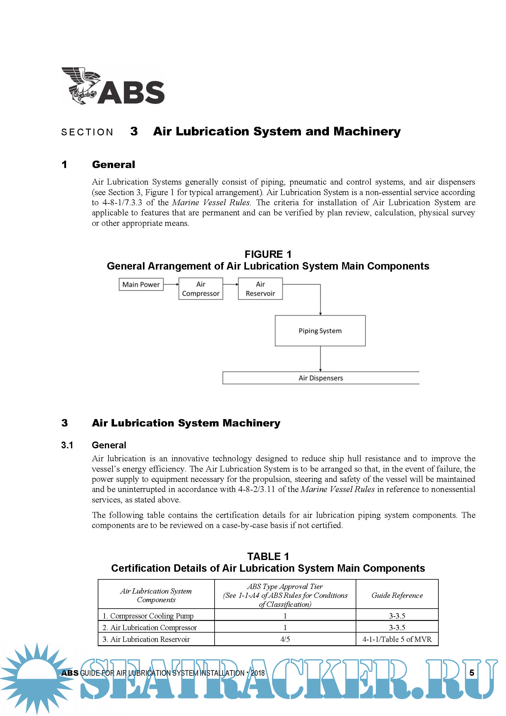

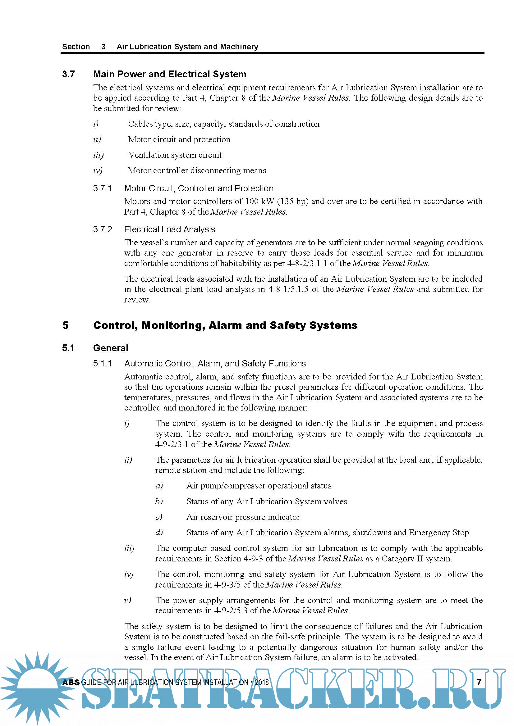

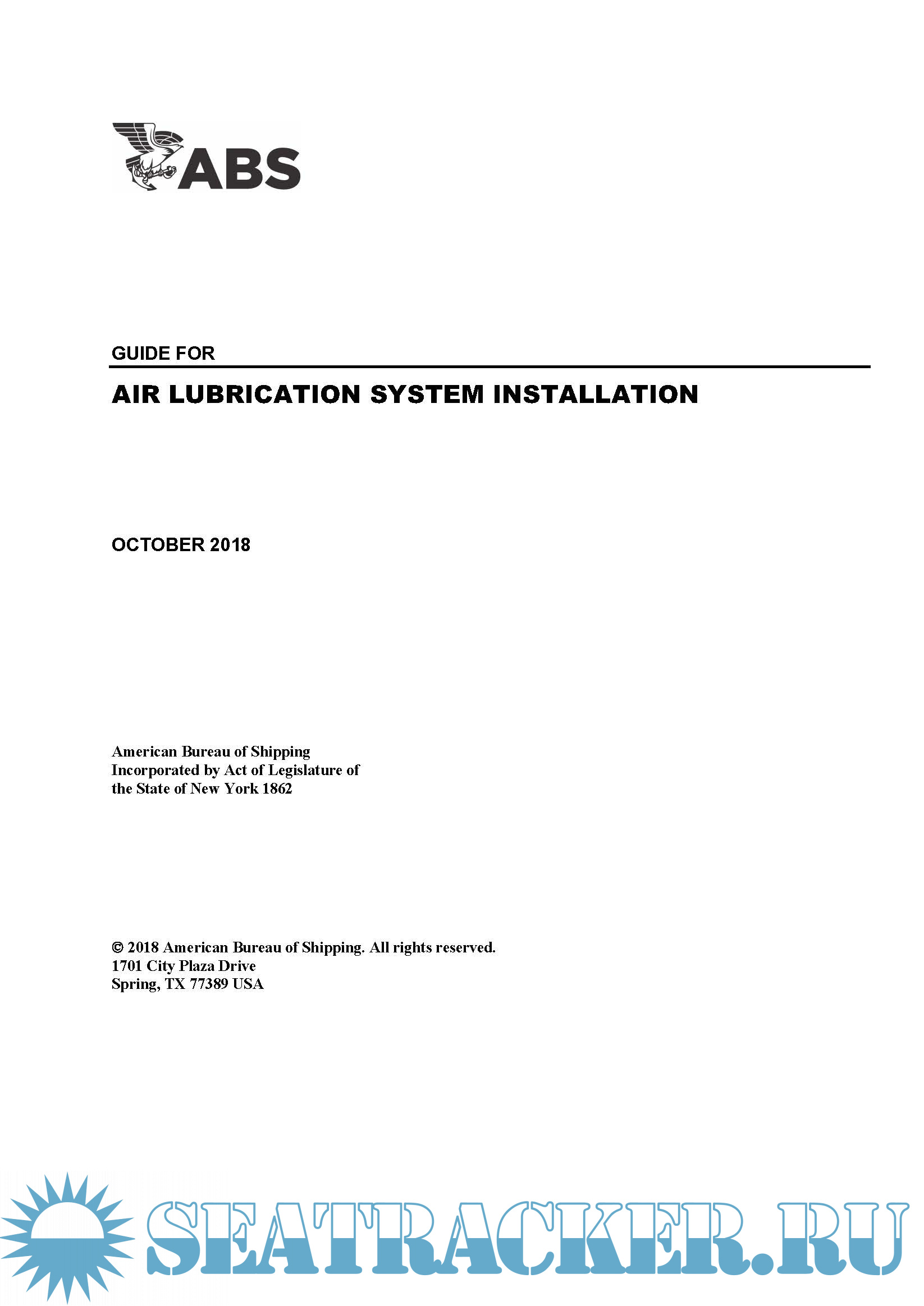

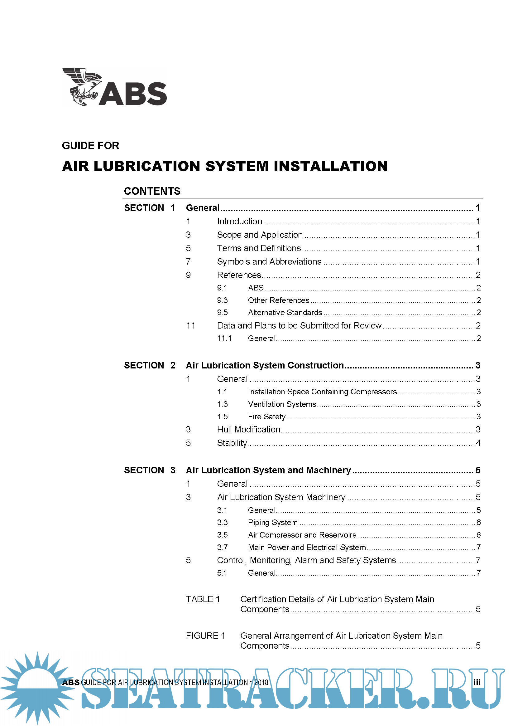

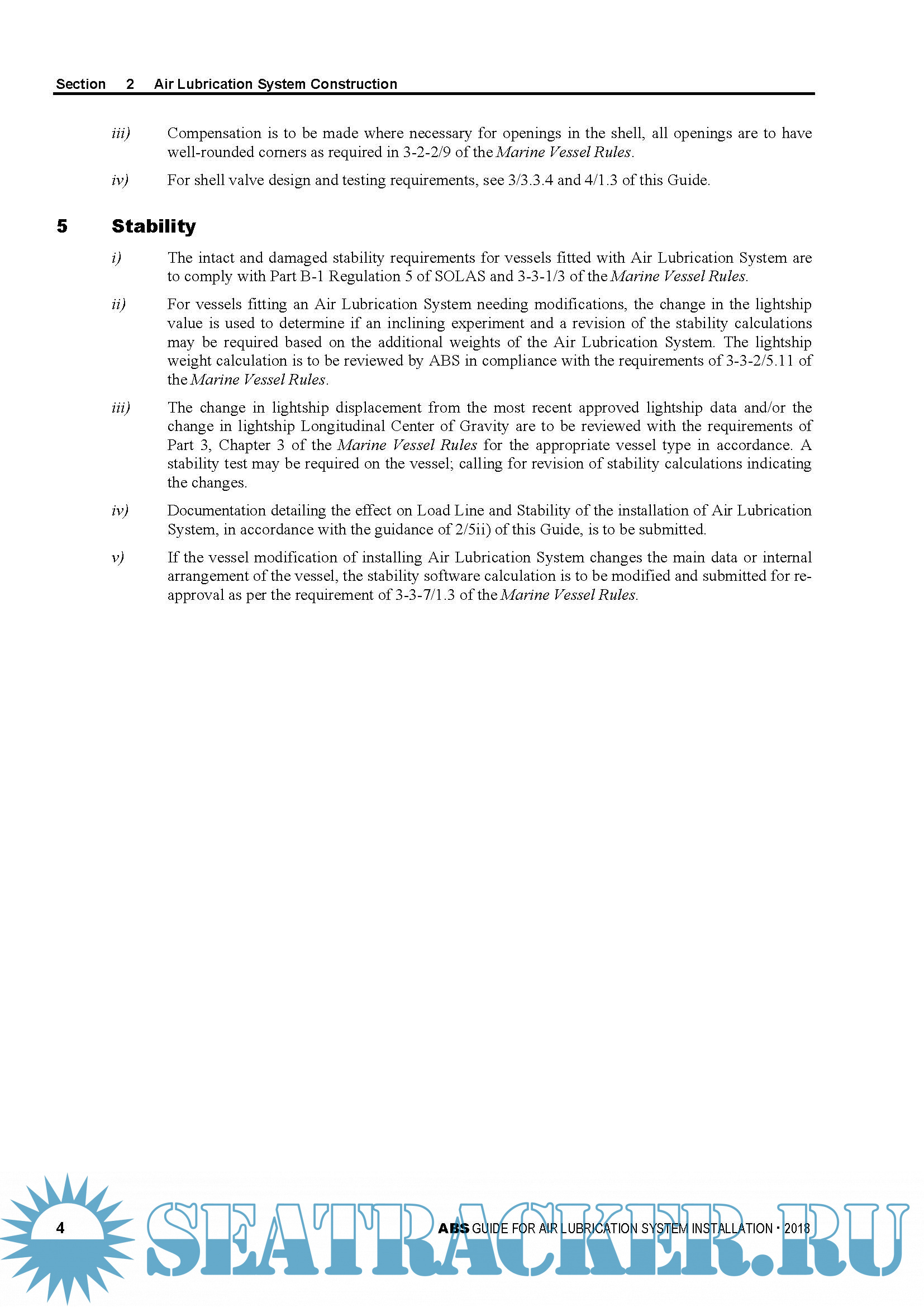

Guide for Air Lubrication System Installation
Year: 2018
Author: ABS
Pages count: 12
Description: This Guide is applicable to three air lubrication technologies: air bubble, air layer and air cavity methods,
which are currently in various degrees of development by the industry. These technologies are continuously
evolving. Alternative arrangements, designs and technologies may be acceptable on a case-by-case basis
provided they can be demonstrated, through either satisfactory service experience or a systematic analysis
based on sound engineering principles, to meet the overall requirements of this Guide.
The effective date of this Guide is the first day of the month of publication.
