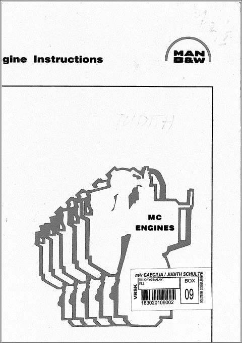

Instructions for main engine MAN B&W L50MC/MCE Volume II: "Maintenance"
Author: M.A.N.-B&W DIESEL A/S
Genre: Instructions
Publisher: M.A.N.-B&W DIESEL A/S
Number of pages: 400
Description: INSTRUCTIONS FOR MAIN ENGINE TYPE L50MC/MCE MAINTENANCE
This book forms part of a set of books consisting of three volumes entitled:
Vol. I OPERATION
Vol. II MAINTENANCE
Vol. Ill COMPONENTS AND DESCRIPTIONS
The purpose of these books is to provide general guidance on operation
and maintenance and to describe the constructional features of a standard version of the above engine type. Deviations may be found in a specific plant. In addition the books can be used for reference purposes, for instance in correspondence and when ordering spare parts.
It is essential that the following data is stated in spare parts orders as it is used by us to ensure the supply of the correct parts for the individual engines:
1. Name of vessel
2. Engine No. built by
3. Plate No.
4. Part No.
5. Quantity required (and description)
Example: M/S Nybo - 7730 B&W - 90201 - 00 - 059 10 off (piston ring).
If the parts list indicates a "B&W standard No.", this should also appear in your order.
The designation "D" used in texts and illustrations refers to the information given on the data-sheets inserted in the respective books.
As reliable and economical operation of the diesel engines is conditional on correct operation and maintenance, it is essential that the engine-room personnel is fully acquainted with the contents of this book.
This book is subject to copyright protection. The book must not, either wholly or partly, be copied, reproduced, made public or in any other way made available to a third party without the written consent to this effect from B&W Diesel A/S.
Stamholmen 161 . DK-2650 Hvidovre - Copenhagen . Denmark Cables: bwdiesel . Telex: 16573 bumei dk . Telephones +45 1 492501
