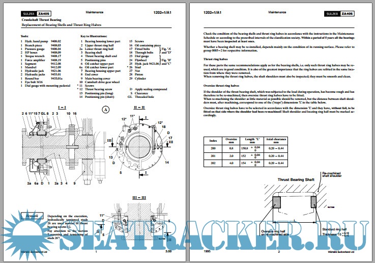

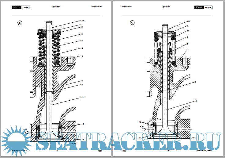

Sulzer ZAV40S (Maintenance, Operation, Spare Parts)
Year: 2004
Author: Wärtsilä Corporation
Genre: Technical book
Publisher: Wärtsilä
Pages count: 313+288+325
Description: The instructions contained in this Maintenance Manual are meant to contribute towards correctly handled maintenance work to be carried out at specific intervals.
It has been assumed that the staff put in charge of such work possesses the required mechanical knowledge and practice.
Indications on the engine operation as well as the description of the function of specific systems are contained in the Operating Instructions. In this manual you can find also under group 0010---1 and 0040---1 explanations to the lay-out and use of the Operating Instructions as well as of the Maintenance Manual.
More detailed instructions on the operation and maintenance of components from sub-suppliers can be gathered from
the instruction leaflets of the respective manufacturers.
