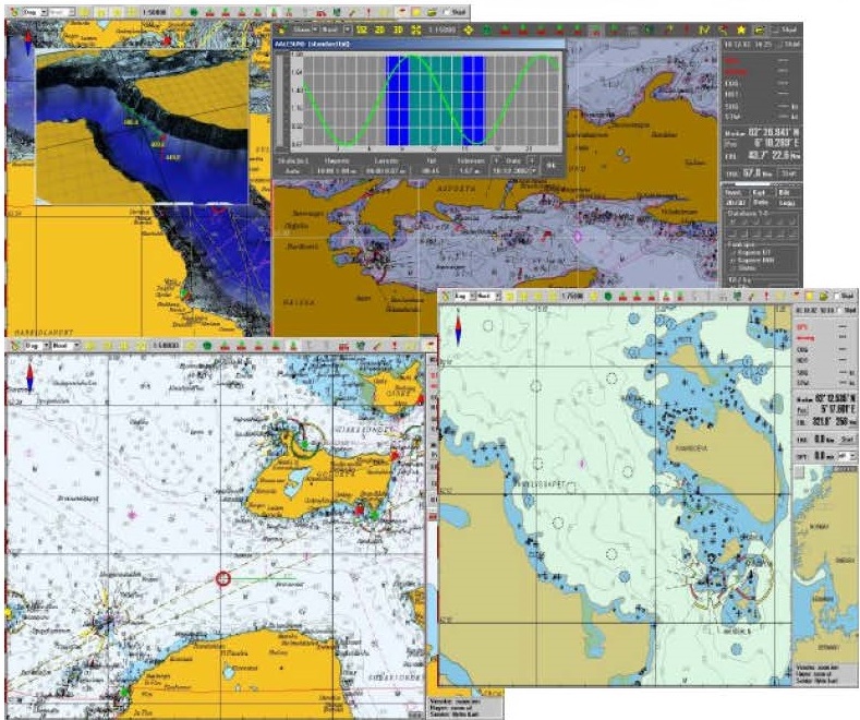

Description: TELchart is an electronic charting system (ECS) for maritime use. The system makes use of vectorized marine charts from C-Map and offers a wide range of functions for navigation, route planning, safety, logging and data presentation.
The TELchart line of products have now been in continual development for more than 16 years, in close cooperation with our partner Furuno Norway's dealer network and end users from fishing, shipping and offshore vessels. In addition, the developers of TELchart themselves have direct experience with marine navigation. This have resulted in a charting system uniquely adapted to user needs while at the same time delivering unsurpassed ease of use.
TELchart maintains its user friendly interface, making the system very easy to learn. At the same time the system can offer a powerful suite of functionality tailored for a wide range of vessel types.

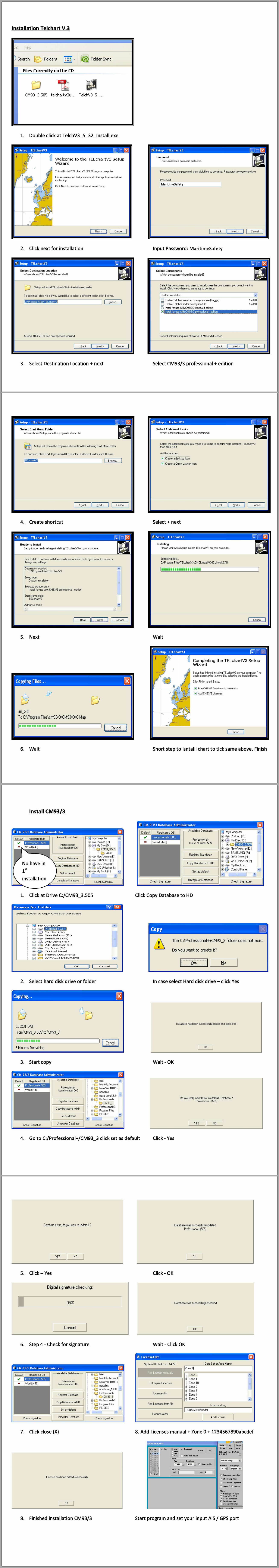

Read first TELchart V3 by Telko AS v3.5.32 installation instructions.pdf
Telchart v3.5.32 installation
Telchart v3.5.32 installation:
1. Run "Telchart v3.5.32 setup.exe" and use the Password: MaritimeSafety
2. During installation choose the option "Install to use with CM93/3 professional+ edition"
3. Let the installation finish and install the charts.
Telchart v3.5.32 charts installation:
1. mount or extract "CM93 v3 (S57) WF766 (June 2016).iso" and copy (all files) to any folder on your PC where you like
(for example C:\CM93ed3-WF766)
2. Run C:\Program Files (x86)\cm93v3\System\GDBAdmin.exe,
show the path to CM93ed3 chart Database location (for example C:\CM93ed3-WF766), Register Database and Set it default.
3. Run C:\Program Files (x86)\cm93v3\System\LicenseAdm.exe.
4. Choose Zone 0 using “1234567890abcdef” as the key.
5. If you get a message that your license is expired or that will expire soon,
try to change this key randomly, between the codes bellow, until you get it.
0123456789abcdfe
0123456789abcdfe
1234567890abcdfe
0123456789abcdef
123abc456def7890
2222222222222222
ffffffffffffffff
9999999999999999
You can use whatever key combination you want, as long as it is made of 0-9 and/or a-f.

m@riner   28-Jun-2016 21:58
Installed program and registered/licensed charts but I'm getting a message
C-Map
g_manager->init() failed
What am I missing
Thanks in advance
7
m@riner   28-Jun-2016 22:33
Ok, fixed, apparently one HAS TO COPY the database to the PC. Thanks for sharing!

reza.seaman   30-Nov-2016 02:05
23873Installed program and registered/licensed charts but I'm getting a message
C-Map
What am I missing
Thanks in advance
Run Program as Administrator.
