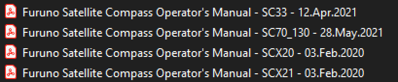

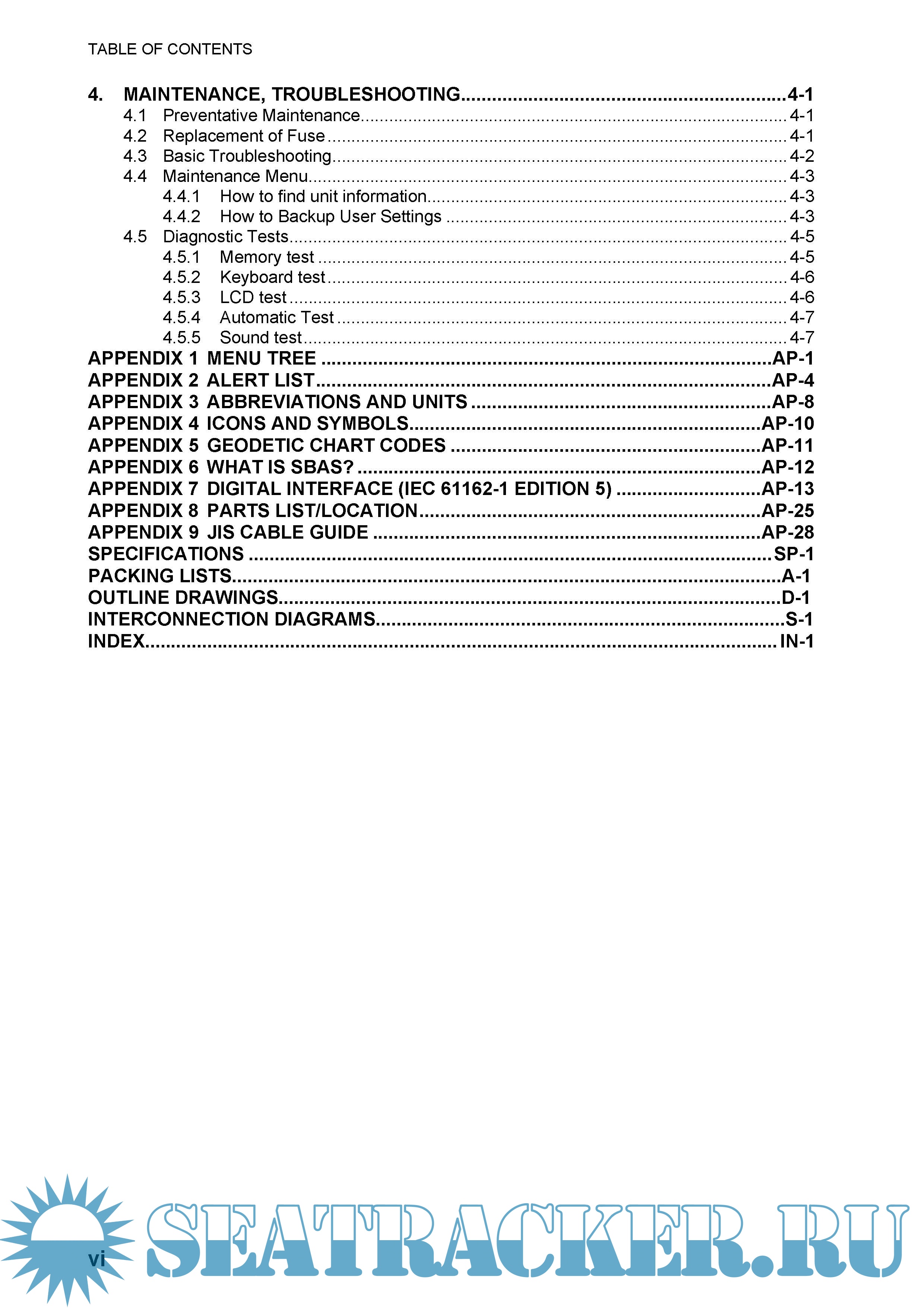

Furuno Satellite Compass Operator's Manual (SC33, SC70, SC130, SCX20, SCX21)
Year: 2021
Author: FURUNO
Publisher: FURUNO
Pages count: 376
Description: • This manual has been authored with simplified grammar, to meet the needs of international users.
• The operator of this equipment must read and follow the instructions in this manual. Wrong operation or maintenance can void the warranty or cause injury.
• Do not copy any part of this manual without written permission from FURUNO.
• If this manual is lost or worn, contact your dealer about replacement.
• The contents of this manual and the equipment specifications can change without notice.
• The example screens (or illustrations) shown in this manual can be different from the screens you see on your display. The screens you see depend on your system configuration and equipment
settings.
• Save this manual for future reference.
