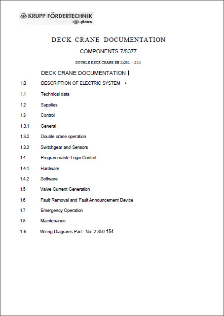

Description: DECK CRANE DOCUMENTATION COMPONENTS 7/8377 DOUBLE DECK CRANE EH 2x25t - 22m
DECK CRANE DOCUMENTATION I
1.0 DESCRIPTION OF ELECTRIC SYSTEM
1.1 Technical data
1.2 Supplies
1.3 Control
1.3.1 General
1.3.2 Double crane operation
1.3.3 Switchgear and sensors
1.4 Programmable logic control
1.4.1 Hardware
1.4.2 Software
1.5 Valve Current Generation
1.6 Fault Removal and Fault Announcement Device
1.7_ Emergency Operation
1.8 ftfte'ntenance
1.9 Wiring Diagrams Part-No. 2 350 154
2.0 SPARE PARTS LISTS - ELECTRIC SYSTEM
DECK CRANE DOCUMENTATION II
3.0 DESCRIPTION OF HYDRAULIC SYSTEM WITH DIAGRAM
3.1 SPARE PARTS LISTS - HYDR. SYSTEM WITH DIAGRAM
3.2 SPARE PARTS - HYDR. SYSTEM - COMPONENTS
3.3 SPARE PARTS DOCUMENTS -PURCHASED PARTS
DECK CRANE DOCUMENTATION COMPONENTS 7/8377 DOUBLE DECK CRANE EH 2x25t - 2 2m
1.0 DECK CRANE DOCUMENTATION I
DESCRIPTION OF ELECTRIC SYSTEM •
1.1 Technical data
1.2 Supplies
1.3 Control
1.3.1 General
1.3.3 Switchgear and Sensors
1.4 Programmable Logic Control
1.4.1 Hardware
1.4.2 Software
1.7 Emergency Operation
1.8 Maintenance
1.9 Wiring Diagrams Part - No. 2 350 154

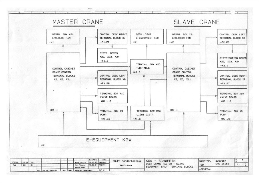

The cranes can be operated separately in single operation.
In double (GEMINI) operation the cranes are connected in parallel and controlled from the A-Tower (master crane). The drives are then synchronized.
In the description of the electrical system the guiding crane is called ’’master crane", the crane following is "slave". In the component list the cranes are designated with M of S respectively.

1. General remarks
Both cranes can be controlled simultaneously from a single control station in the double crane mode. The motions of the two cranes are synchronized.
The crane column from which the cranes are controlled in the double crane mode is called the master crane. The other is the slave crane.
The two cranes can only be controlled from the master crane in the double crane mode. The slave crane control functions are blocked.
