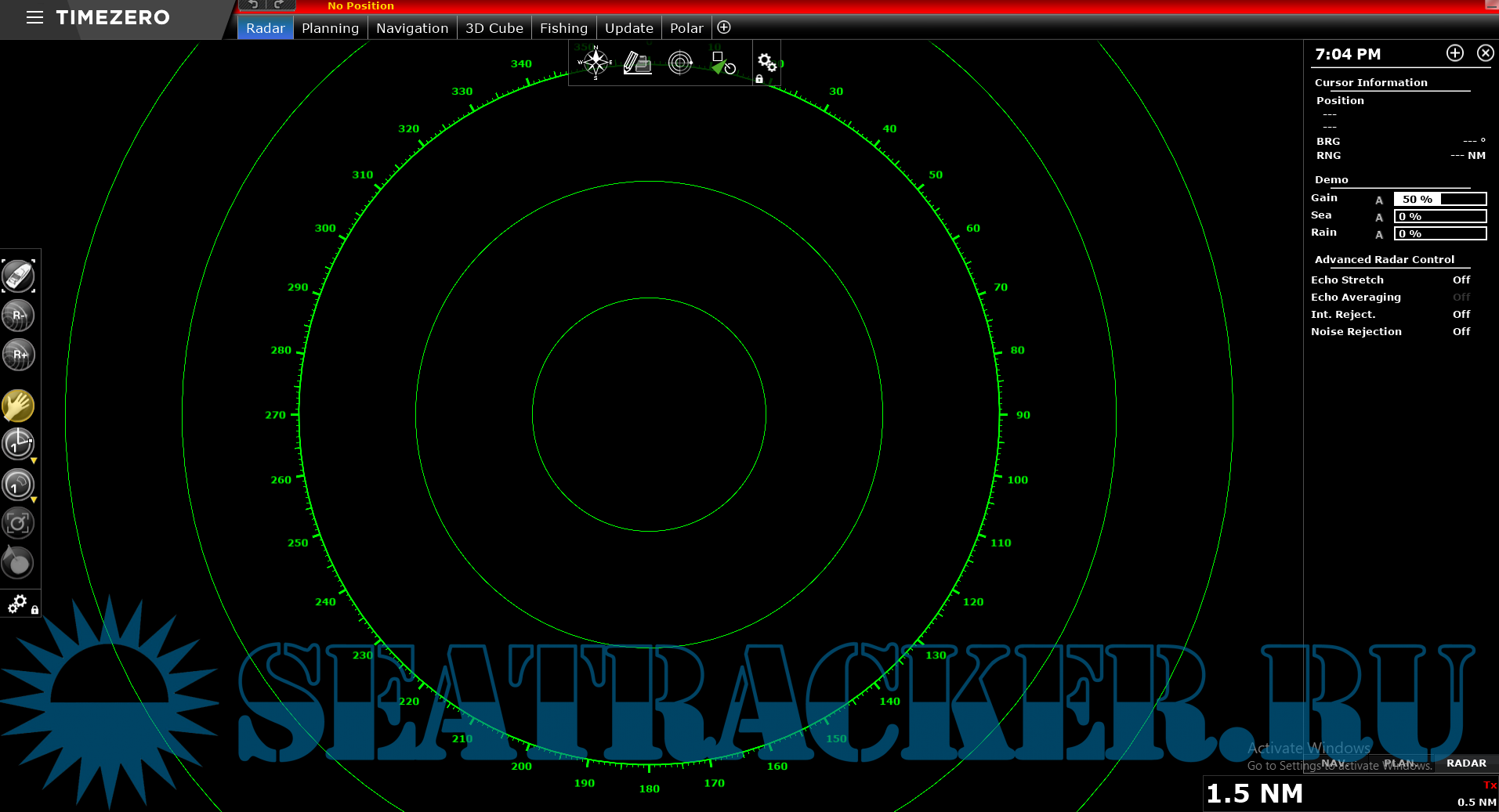

tomado ®   23-Feb-2023 21:42
capellidipaglia, Good day ,
Is the Radar module enabled on your TZ ?
You just need to do the following steps:
- in Option > Initial setup > Advanced > select "generic" radar and quit/relaunch
- the radar doesn't work but the radar workspace and ribbon menu appear…
- a. create a new custom workspace with for example Nav and Radar
- b. in the Navigation workspace, use the ribbon to select "radar overlay"
- go back in Option > Initial setup > Advanced > select your radar and quit/relaunch
- the custom workspace still displays the radar and a way to manage it
- the navigation workspace displays the overlay when the radar is on Tx
2

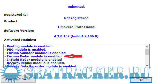

capellidipaglia   23-Feb-2023 22:08
90213capellidipaglia, Good day ,
Absolutely yes, I have every module possible. Like the picture you showed.
https://i.postimg.cc/tCXnyvK6/Cattura2.jpg
But as I show you in this image, I don't see any symbols that refer to how to access the radar mode.
https://i.postimg.cc/W4K01mGv/Cattura.jpg
2
