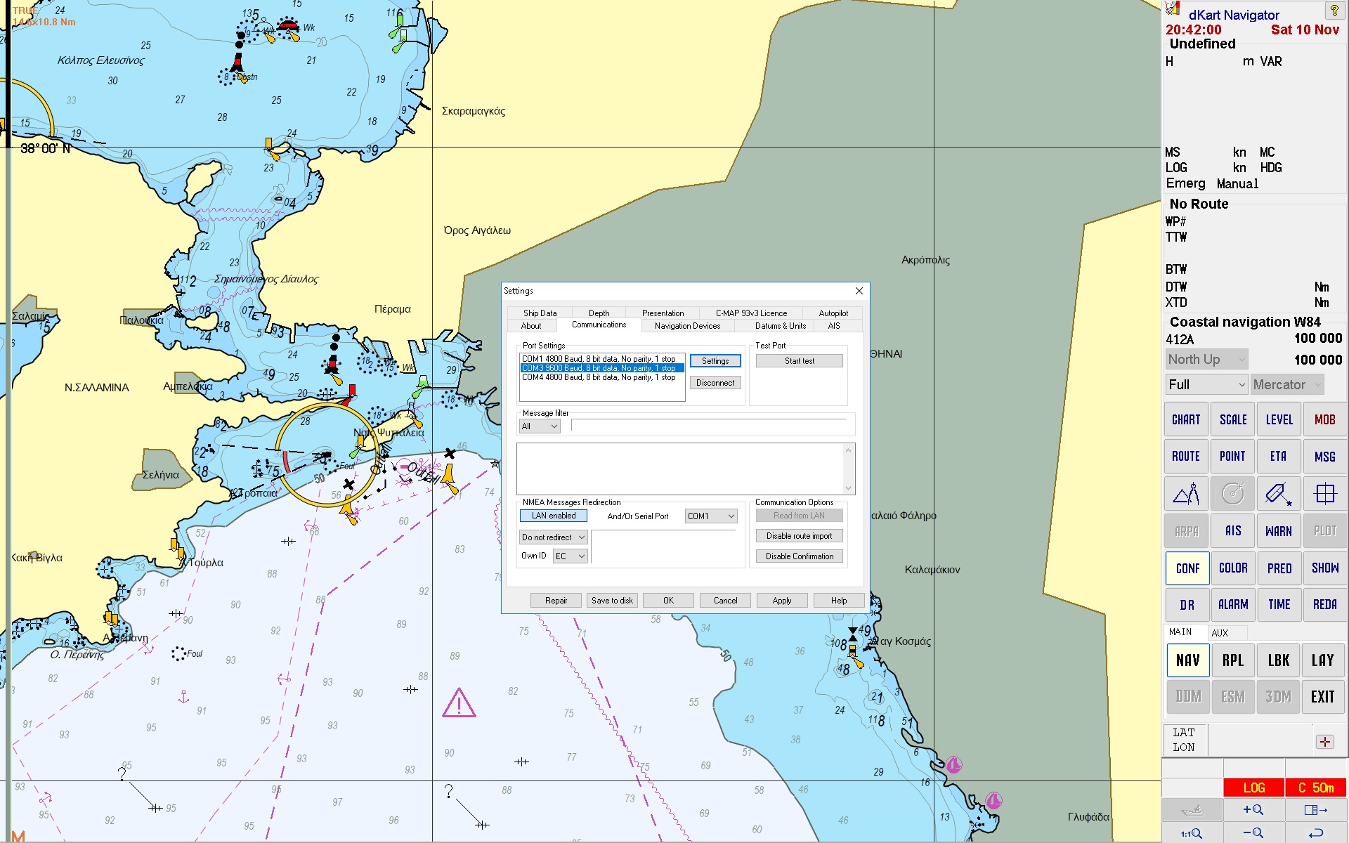

46789onlinespiderman, GPS can not be connected, while trying adding it in the menu ---config--- navigation devices.
There are no COM ports available to add the GPS.
Any one can help in this matter.
Thanks.

onlinespiderman, yes i have a Garmin Bluetooth GPS. and when it is connected to the laptop it creates a serial com port, but in the menu of the navigation devices i can not find any com port to chose to add my GPS.

First of all thank you for share onlinespiderman.For GPS connection you must know which com port gps is connected.
Go to MyComputer,right click,manage,device manager,ports.Example COM port 4.Double click,Port Settings and configure the Bits per second or(Baud Rate) to 4800.
Open dkart,co to SetUp,Conf,Navigation Devices,Main Positioning System...scroll and click AUTO.This open configuration window(GPS Device Settings).
Set Mode Customize,choose Comm Port,Example COM port 4,Device ID(Any) and Messages(RMC).
Now go to Communications,you will see the choosen port,Settings,Serial port 4 settings,set Baud Rate to 4800(leave the others as it is)Apply and OK.
Apply also to Settings window OK,and here it is.
Hope that helps,have a nice trips!!! Может по пиву?
P.S:dkart installed on WINDOWS 7(without SP1)without any problem.Also do this steps for the other Devices.For AIS i use an RTL DVBT dongle with PNAIS and Franson GpsGate Software.
